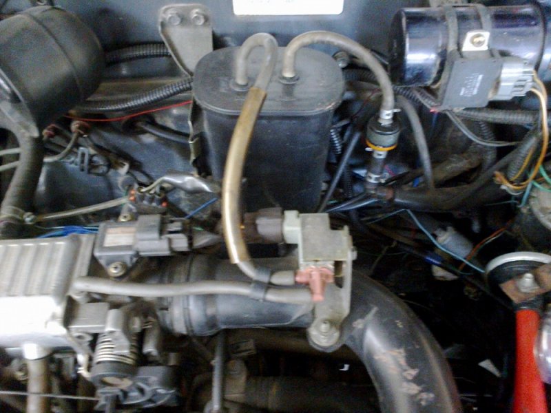

Re: Petrol smell inside the car / Issues in Maruti 800
Got the Breather pipes cleaned by using vacuum pump, also changed the pipes, the smell had disappeared for 2 days, again started.. So please suggest.. Here is a pic for reference
May 1, 2011
3,594
761
Yes, no leaks, as I told I have changed all the pipes but same issue..

Re: Petrol Smell inside the Car / Issues in Maruti 800
But the smell increases a lot, if I turn on the blower/fan the smell increases more..
In my friend's 800, they have totally disconnected the breather pipe, he is having no issues.
Is this a solution ?
NEVER disconnect the breather pipe. It could prove extremely dangerous. Please get all the fuel lines checked. There is definitely a fuel leak somewhere which is the cause of the smell.
