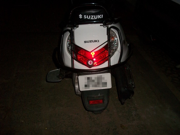

Adding Brake / Tail LED light
What i miss when changed to a gear less two-wheeler
1. Engine brakes when going down on an incline
2. Tall seating position
3. wide handle bars
I have changed the Tail lamp to LED
type BA15D
LED Bulb
when brakes are applied (the light is a running type)
console light in dark (sorry for the blurry ones)
Number plate illumination

Congrats on your new scooter. Even I own a Suzuki Access at home & it has completed 32,000km in the past 4 years. Its doing quite good & didn't give any issues so far.
Btw, the lights are looking cool! [:)]

Re: Adding Brake / Tail LED light
type BA15D
Please let me know where can I get this, I have been replacing 2-3 bulbs in a month I don't why its fuses every time. [frustration]
