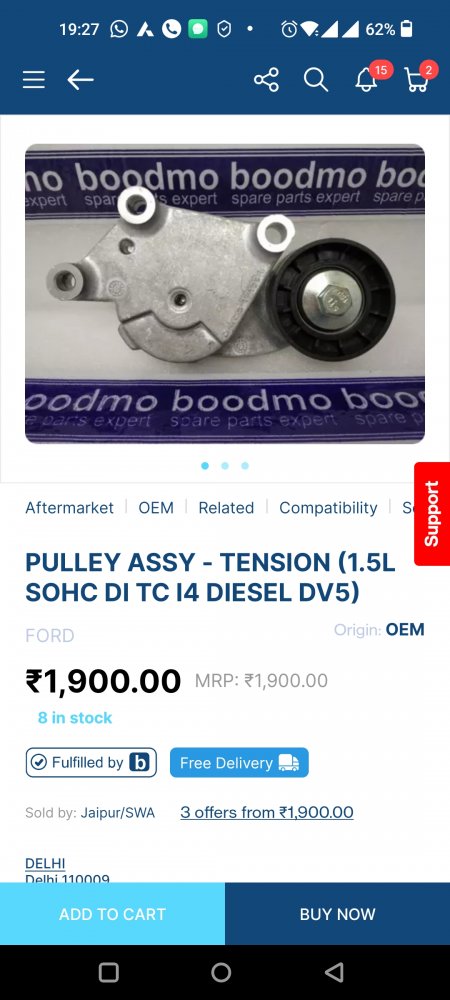

Also the part which was making noise was the tensioner Pulley.

8. Tensioner Pulley - 1880
