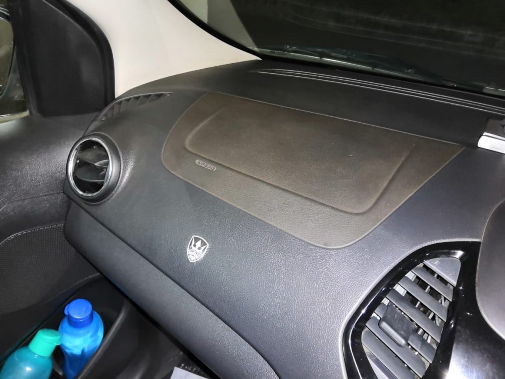

My aspire 1.5 diesel has run 27k kms in 3 yrs + . Just completed third annual service in January first week . And suddenly I noticed a weird problem. The front passenger side airbag panel has turned almost brown. As if the colour has faded away. I dont remember having this before the service . Did they replace it during service? Is it routine to open that during service? Did the colour fade away due to cleaning with some solvent during service? Completely confused there. Please see the attached photo. It is better appreciated in sunlight!

The cover is made of the same material as the entire dashboard. If there was some reaction it would have covered more area and not limited to just this cover.
Get it checked asap. Have heard many big companies changing parts from customer's car. Get it checked in front of you.
Your guess (highlighted part) looks to be correct. Cleaning with a discolouring/strong solvent wont make such a neat outline.
Thats Very Weird. Airbag is not a serviceable Item. If it was replaced with a Faulty/Dummy one, There should be Airbag Light on the dashboard. Check if Airbag fuse was removed or Relay shorted to Prevent the Light.
Other very likely reason is overuse of harsh Chemicals like Sanitizers. These things wreak havoc on Paint & Leather. Details in my XUV thread-
The dirt makes it look like a swapped part.
One of the Ford dealers here was infamous for swapping parts.
