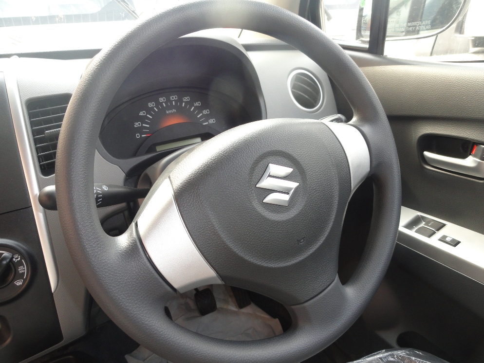

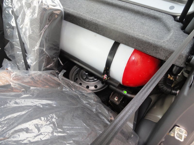

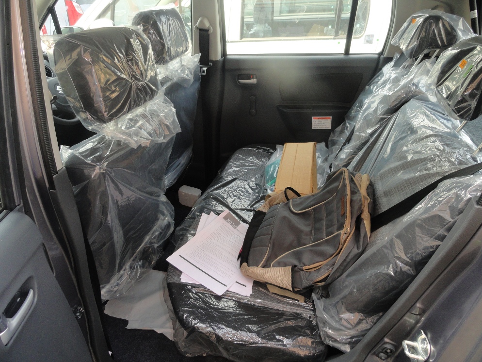

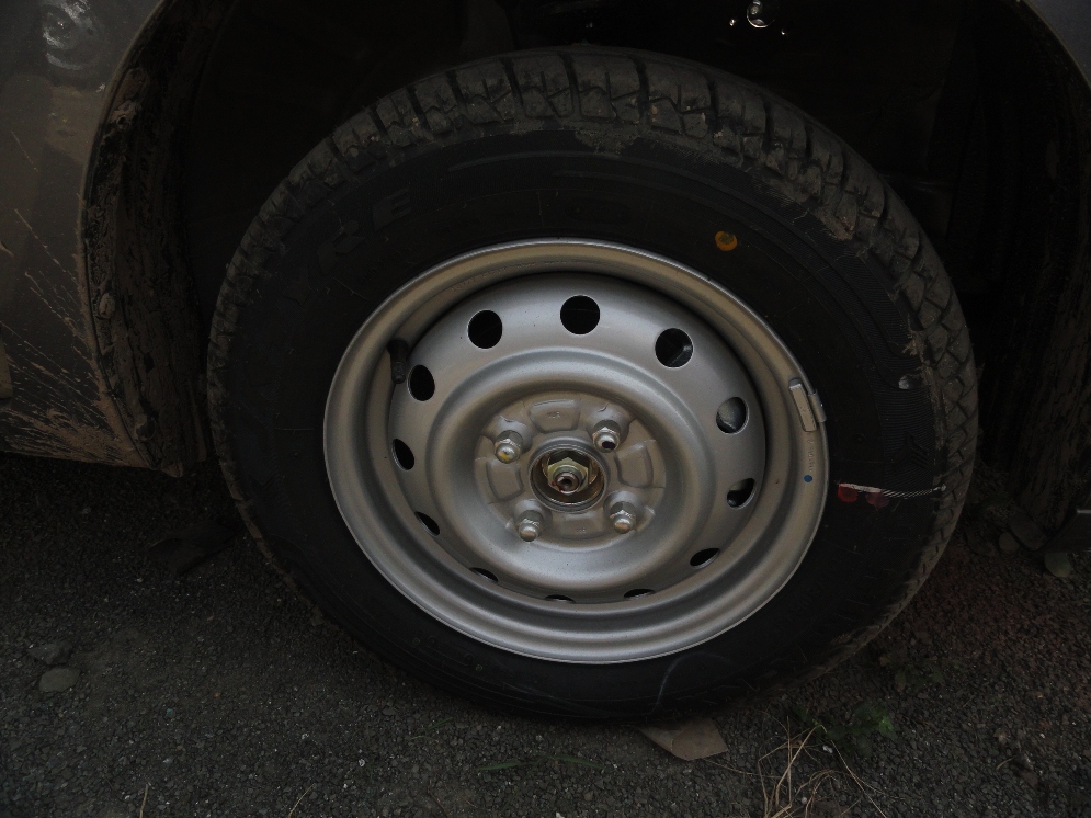

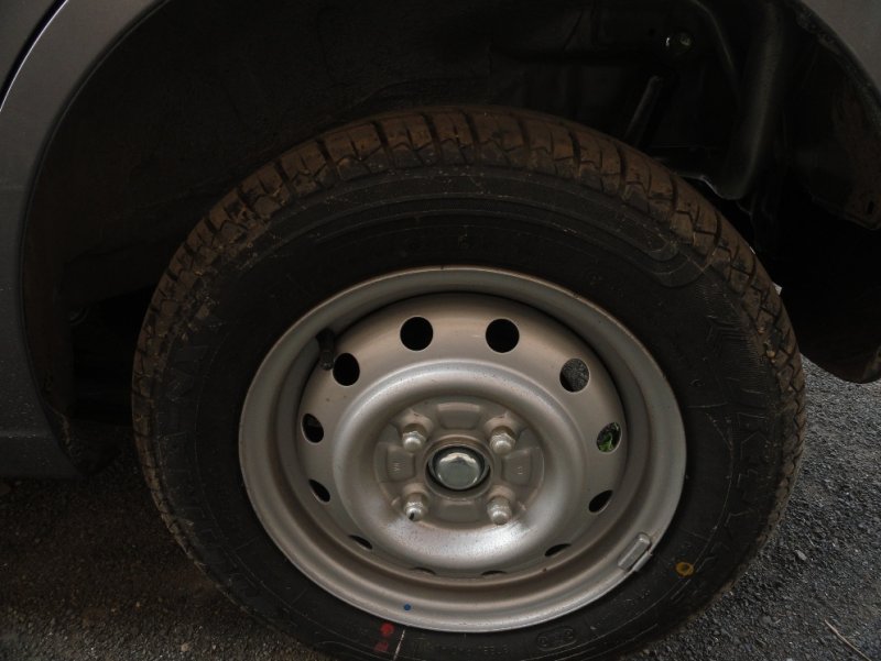

herewith i am attaching the pics for my 1st PDI at the stockyard,for me it was absolutely perfect and ideal car but i still want your opinion about the appearance and technical aspect before registering it on my name.
more pics for you.
Congrats on Wagon-R. Your car seems fine overall except that it’s missing hubcaps (black cap in center of wheels). Please ask for it and ensure to take a thorough TD.
yes thanks a lot vibhor,actually hub caps are there in the back seat.they are in black color and yet to be fixed before delivery. actually the mechanic from that stockyard helped me a lot and he explained me everything.i could not take along any friend of mine with me.he only told me that hub caps will be fixed before car goes to showroom.he was so informative and was willing to give me so much information that i gave him 5o rs. for his help.but i am truly satisfied.and it was not allowed for a TD from stockyard though i did it within stockyard area.(i know i can not call it as a TD) what to do?
and one more point is that i did thorough PDI but missed 1 or 2 points like although its odometer is 9 kms, but i did not check speedometer connected or not and 2-3 more points.
