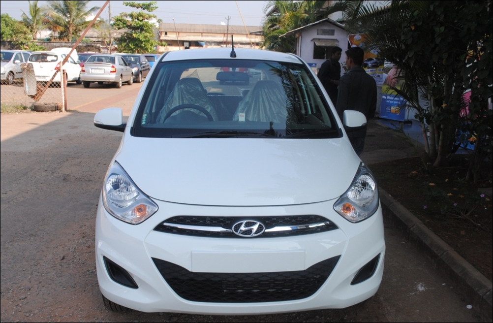

Switch on and off to test all the lights (Headlamps, Foglamps, Stoplamps, and Indicators etc).
Difficulty to pull up the boot indicates a faulty hydraulic system.
Watch out the mirrors and windows for breaks or deep scratches.
It is questionable is the seats are not covered with polythene.
Small yet significant. Pay special attention to the fuel lid for damages.
Inspect lower end of the car (Doors / Bumpers) for signs of dents or scratches.
If the car has remote locking, use it and also manually lock / unlock the doors.
Use windshield wash sprayer to scan the condition of wiper blades.
Brand new tyres must have complete tread. And verify their manufacturing date too. Note: Beware of cracked wheels.
If we say check ‘all’ the lights, it literally means all.

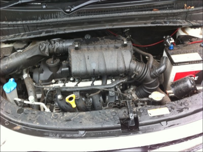

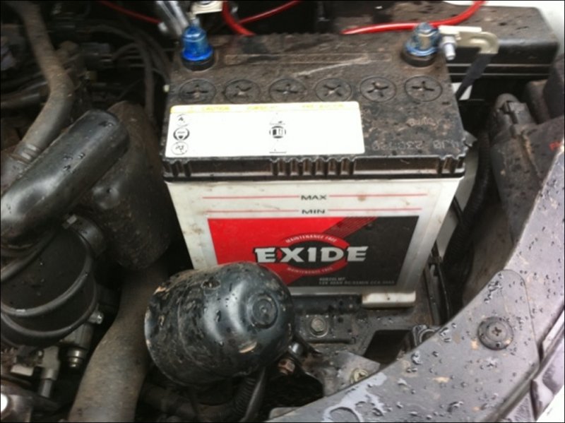

Pop up the hood and take a look on the engine compartment. Everything must appear in good shape and in place. Pull out the dipstick and examine the condition of engine oil. It should be topped up and appear golden’ish in color, darkness means it requires a replacement. Similarly, check rest condition of other essential fluids too (Coolant, Brake Oil, Power Steering Oil etc). Plus, the battery should be new and have its positive terminal covered.

That's how the brand new battery should look like.

Typically that’s how a brand new car’s engine compartment should appear.

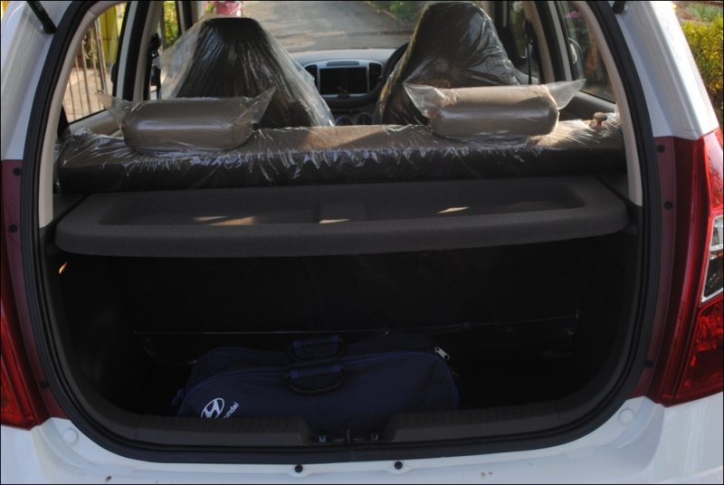

Brand new spare wheel kept intact inside the boot along with other necessary tools.
