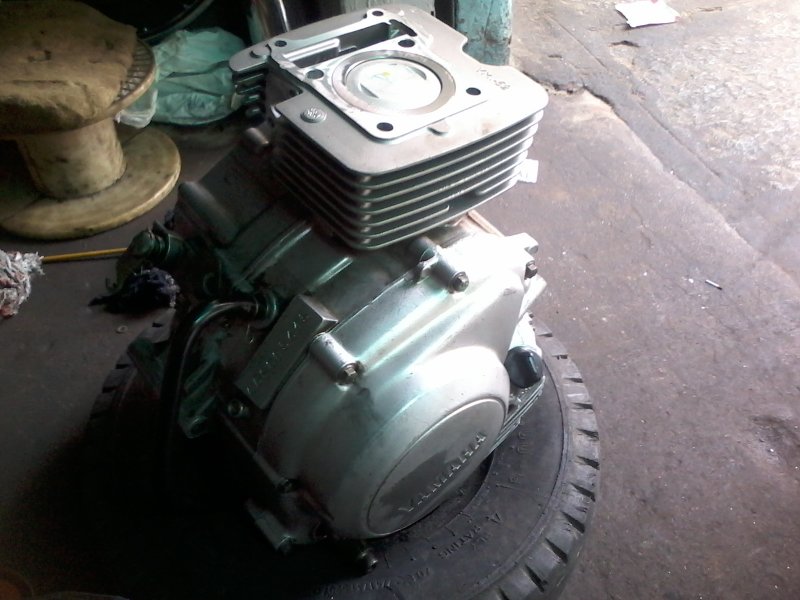

Hi all, lets look at the concluding part ! Even after 15 years, the bike looked new with minimal scratches. The paint and chrome were intact. So i decided not to touch them and rebuild only the engine.
In the month of october 2014, i decided to restore it to its past glory. So started hunting for oe parts. There i came to know how difficult is it to procure oe parts. Yamaha guys have completely stopped supply of parts for ybx, so i had to search for oe parts with automobile dealers across bangalore !
It was my routine practice to enquire at each and every automobile shop en route my work place. None of the spares were readily available, so i had to book them against advance payment and eagerly wait for them to arrive ! The process of acquiring spares itself took nearly a month. Later, my job was to find a good mech to do it. This was even more difficult task, as you all know how competant the mechs are these days !
Finally almost all the parts arrived ! I am making a list of spares acquired below, as this may be useful to other members.

Engine works carried out
1. Crank resetting with new bearings (SKF)
2. Head decarbonizing with new valves
here are the pics

Friends, now comes the engine rebuild story.
As the engine assembly began, some parts were replaced viz, rocker cam, timing chain etc.
My mech took 4 full days to complete engine overhaul. Finally the moment arrived for which i was eagerly waiting for ! A petrol bottle was connected and bike was started. It started, but to my utter surprise, there was a knocking sound coming out of engine ! Mech told me to run the vehicle for a week and the sound will vanish. But even after running it for a month, the knocking sound continued. I was totally down.
I literally fought with him and went to some other mech in my area. The new guy found the root cause of it ! It was actually coming from the big gear wheel behind the clutch bell assy. It is called "driven gear ". Again search started for that part and it was nowhere available. He then machined a faulty tooth on it and fit it back. But luckily the sound had gone and it was all smooth and original !
I thought everything ended smoothly, but it was not. Bike was running smooth with lot of missfires ! Again i started to scratch my head as no mech was able to solve this problem. Later i went to an auto electrician, who carefully examined my magnet coil and adviced me to get it enhanced with extra no of turns. I agreed and work was executed. Voila !, after a nice ride and tune, its all original guys ! I said UFFF... and enjoying it again like before.
Here are the pics ......
