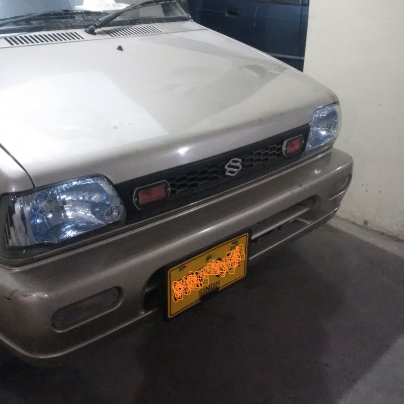

Another thing are the back lights. i liked the old ones which has visible lines and the new ones dont. so i decided to change the lights to old ones. Although people here differ from my choice but its solely my decision. Similarly i also changed the new front grill to an old model which came from 1992-1996 models.
first two pics show how it looks with new lights. And last two pics show how it look with old lights

the grill was too plane so i decided to give a different look. i took the reverse light from our suzuki bolan which was previously called suzuki hiroof ( the advanced model of suzuki gypsy).
i cut the grill from both sides and fixed the lights with screws. bought S logo from market and fixed it also with screws.

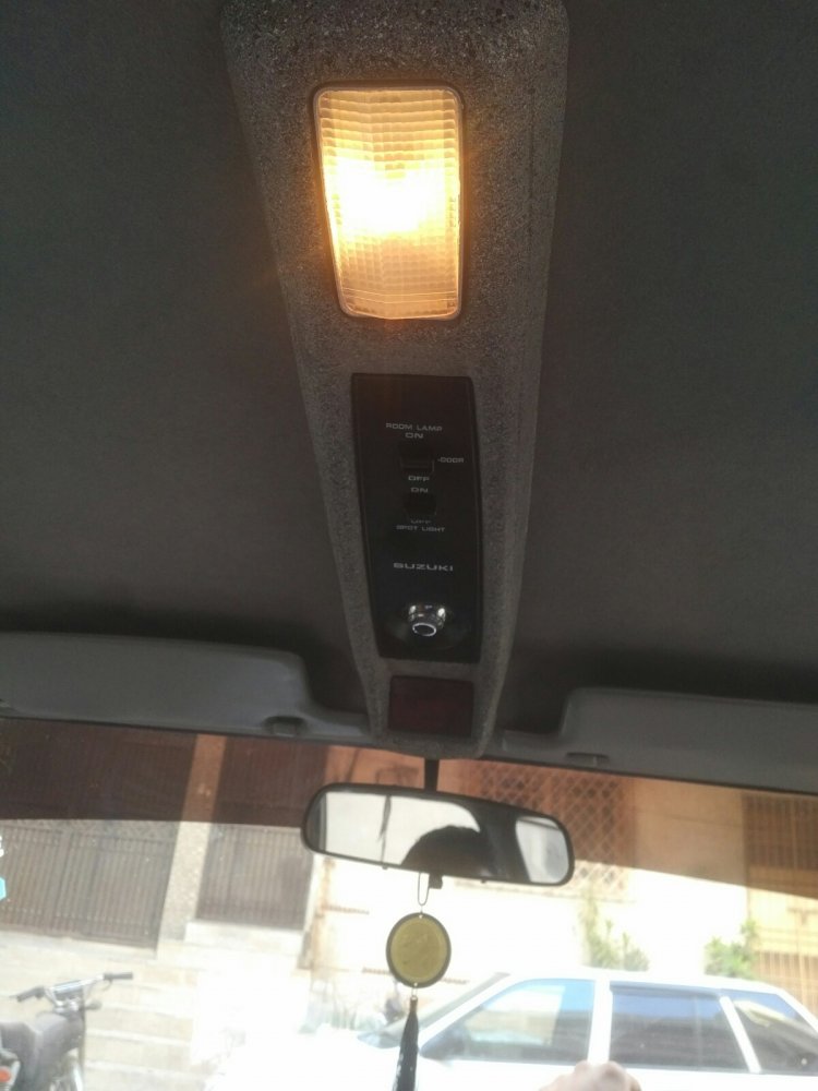

So guys after a long long disappearance from this beautiful forum, sharing again some mods done to the car. The car as Mar 25-2021 has clocked around 55k kms with regular checkups and maintenance. My old id was Nnabeel79 which I couldn't log due to some issues.
So here goes, the first is the roof console. Basically it comes in an old model Honda civic 1978-77 model. I got it from scrap market in bare condition. Basically it is made of foam and its outer coating was gone. the lights were intact so after a lot of searching, my painter guy painted it with some technic using water based paint. It surely gave it a better look. for installation i had to used a metal strip inside the fibre of the roof which should hold the console from the middle.
So i took the measurement, took off the roof fiber, made the metal strip to fit in the middle of the roof with a nut welded to hold the roof console screw.
the metal plate in the console was painted black and new stickers were custom made to match the Suzuki name. here's the final result.
the console contains a Map light and center dome light. an incision was made in the fiber of the roof to pass the metal bracket of the roof console. The original doom light that comes with the back view mirror was taken out and a cheap after market light was purchased and cut so that it covers the area left blank after fitting the console.
