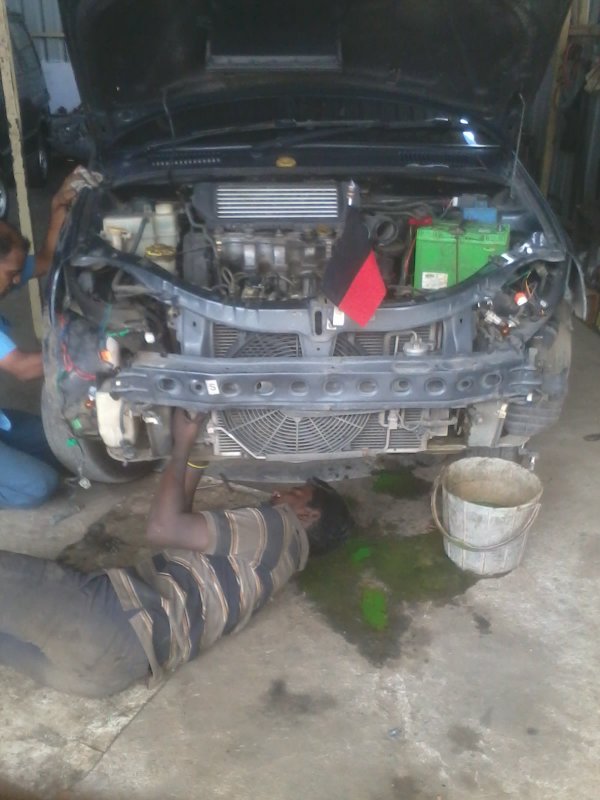

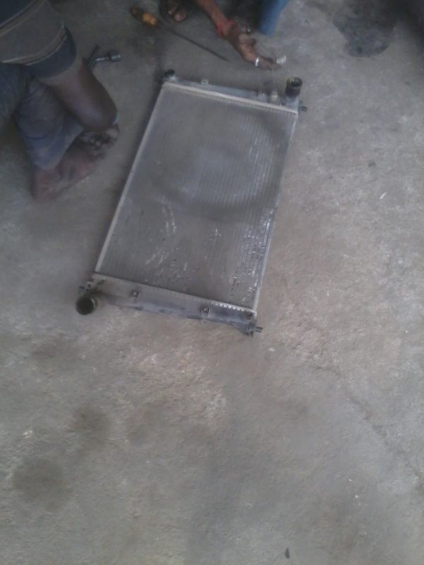

During the recent trip to Periyapalayam temple the car overheated when it hits 90km or above. It seems that AC doesn't work if the car heat needle crosses the redline. So last Saturday took the car to the mechanic and serviced the radiator. He insisted to change the alternator and A\C belt and bearings. While changing he found that a bolt was missing in the Alternator. After finishing mechanical work went to Autoelectrical workshop and put a new bolt.
Total cost:
Radiator service = 1500Rs
Alternator Belt = 350Rs
A/C Belt = 350Rs
Bearings 2 Nos = 475Rs and 425Rs
Alternator service = 700Rs

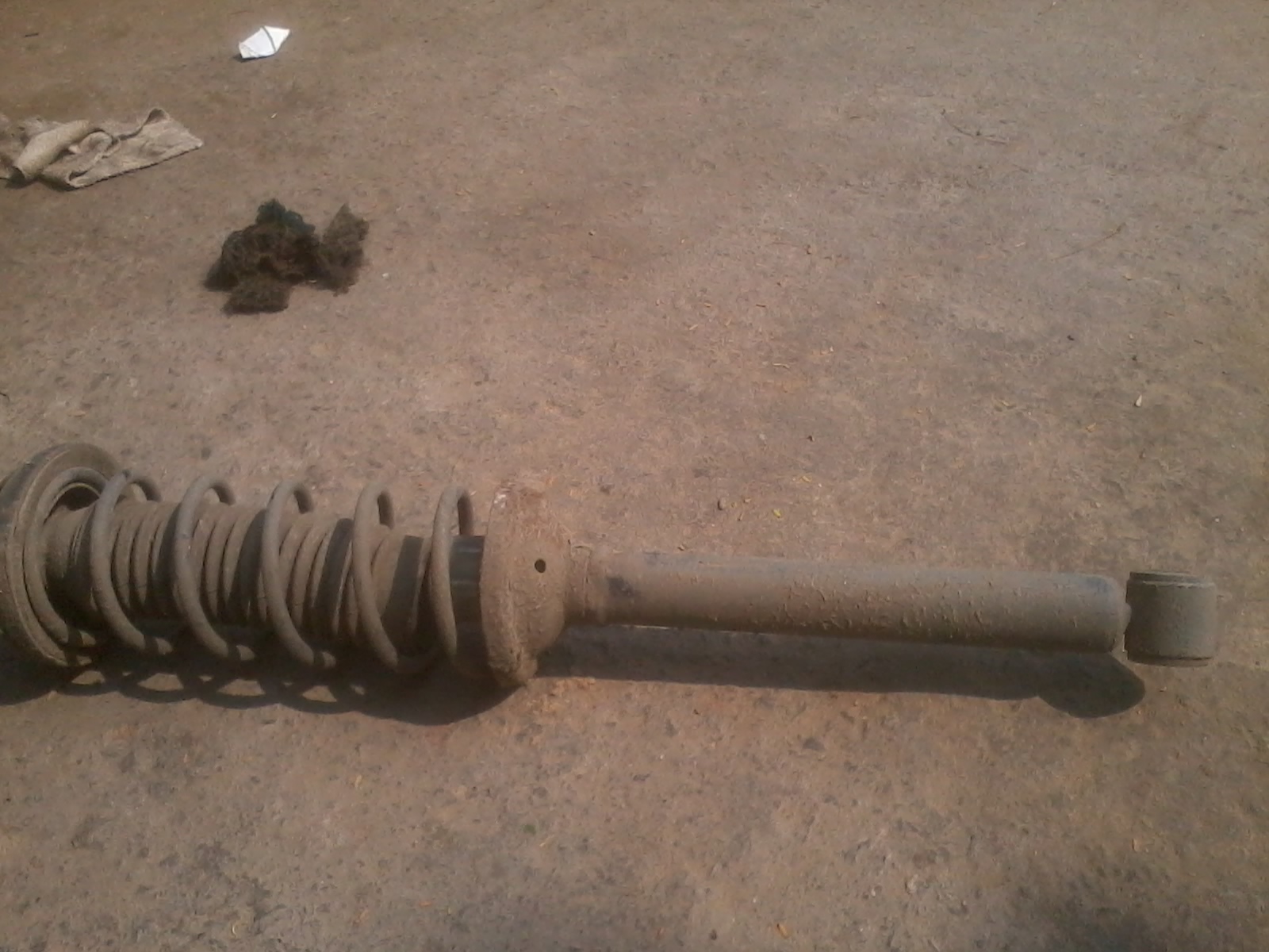

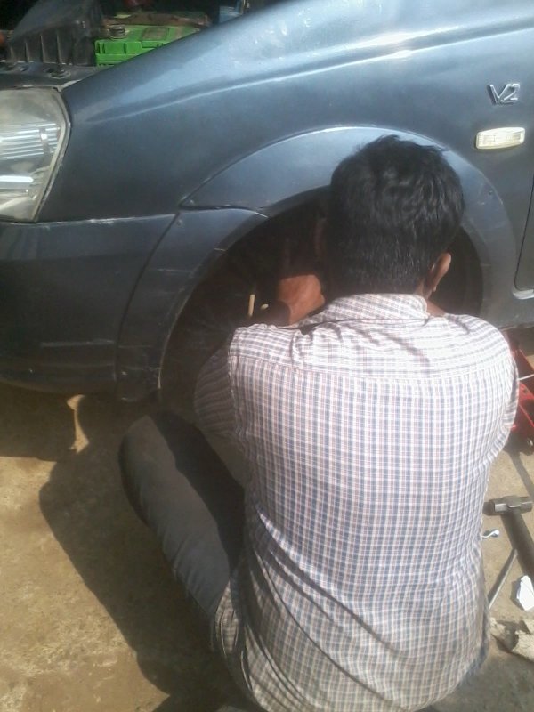

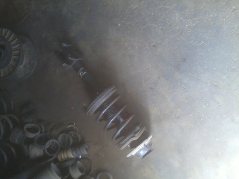

Recently changed all the suspensions, lower arm bush, front brake pads and a new battery. Total damage 20,150rs
The car has now clocked 96000 kms with no hassles.
