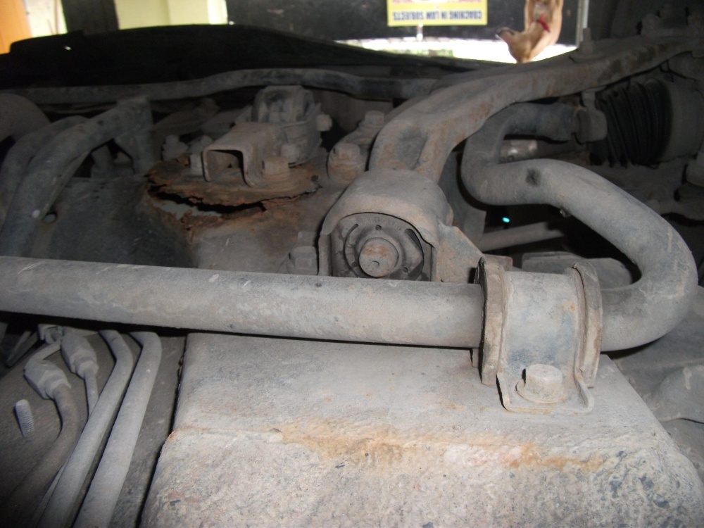

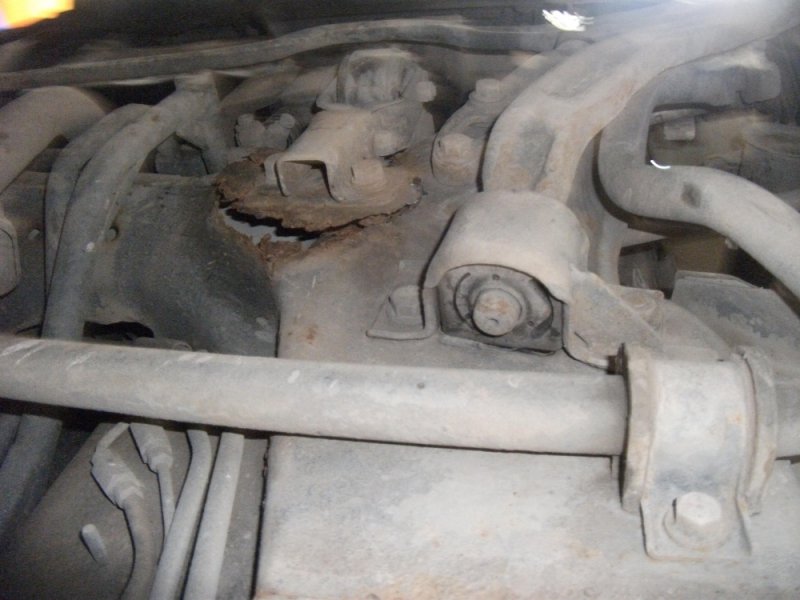

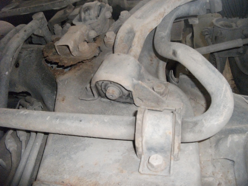

Now a serious problem arised in my car i.e Rust. It seems the engine support has been rust out and engine is shaking[frustration]. Guys now what I want to do[confused].
Thread Starter #60
Oct 13, 2010
208
48
Varun560061 said:
Get it welded, is that the cross member ?
Don't know the technical name. Gave it our regular mechanic said that he will call once the welder comes. Will update if any info I receive.
