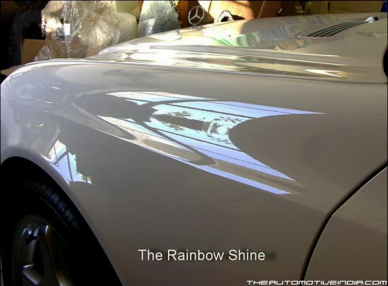

How to maintain the pearly white look on my new car. Can you suggest a nice wax for rich pearl white shine and not the wet look?
Pearl white is my favorable white and give a rainbow shinning if properly maintained. I have written about it earlier and you can try those wax types I used -
Poor Boy’s White Diamond Glaze / Poor Boy’s Natty Paste Wax - which are available in INDIA.
HOW DO I MAKE MY WHITE CAR SHINE?
If you can get it from USA, try this ultimate:
XXX Hardcore Carnauba wax - The Best Wax For A White Car: Chemical Guys White
