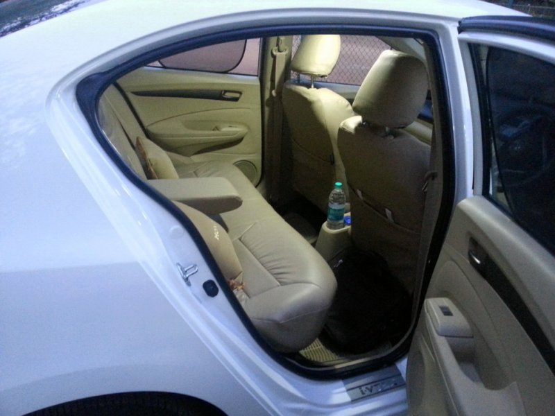

Check these snap shots taken at Chennai, around 6.30 pm. Soon I will upload at night!

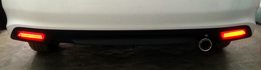

Ebay.com has the Flash strobe control unit @ the cheapest price ie. $ 3.31 per unit. But it requires a complete wire cut as to be pass through which I do not want to do it. Incidentally I have come across in Aliexpress an Innovative LED third brake light provides a stylish custom look and superior visibility – I have ordered.
Flash Strobe Controller Flasher Module for LED Brake Stop Light Lamp LS4G | eBay
Car Red Lens LED Rear Bumper Reflectors Light Lamp 29 Led Brake Tail Parking Warning Light For 2012 UP HONDA CITY-in Brake Lights from Automobiles & Motorcycles on Aliexpress.com
Received. It is a Direct-fit, gets exactly into the reflector slot of rear bumpers. The quality is good and I won’t say great. The visible lens part is very good but back casing is of plastic, though they claim ABS. The LEDs are excellent, works well in both parking and break mode. The Flash strobe control unit is rooted through its wire and in turn the LED third brake light was connected to rear Tail (parking and brake lights) assembly connection line by carefully slicing their wires!
This ‘Brake Attention Flasher Module for LED Brake Lights / Rapid Flash Then Steady On function, works beautifully.
I really love the way it works. It flashes fast for about 3 seconds (6 flashes) then flashes slow for about 3 seconds (3 flashes) then it stays on steady until you release the brake. The cycle starts again immediately if you hit the brake again. Very easy installation....I understand that it not only works for LED, but also for normal filament bulbs of max 15 W output. But better not to overload the output as ours is 21W by direct connection.
ORIGIONAL REFLECTOR
AFTER MARKET​

1. As our (updated) forum website is at present not compatible with active gif images, I am unable to give you the thrill of seeing break light flashing active picture. I shall take a video clip and upload to YouTube soon. Please bear with me, OK?
2. I will not recommend those bulbs which has in built flash strobe chip (Pre-flickering LED brake lamp/light/bulb W21/5W T20 ) for two reasons- one the illumination is not equal to stock one and next, they are very expensive.

Mod looks fabulous doctor. I was thinking of the same but not getting perfect elevation and you have done it. L'll surely done this in coming days. [:)]
As you mentioned you sliced wires and regarding that i have question in mind. Does it'll not affect your warranty? If there is no wire cutting then I am really interested for this mod. Kindly guide me on that.
And we all are eagerly waiting for the video of the same.

Excellent research @Dr MUDHAN.
Unfortunately mine is 2009 model and it hasn't got Rear Bumper Reflectors/brake lights below. I really miss that rear bumper design of 2012 model. :(
But I will try to find others ways to install Flash strobe breaking lights.
btw; Two flasher modules are needed for two leds (left & right) or only one can be used (Parallelly connected)?
