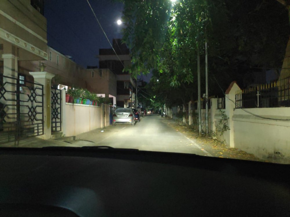

scene 1 : well lit street
Ambient lighting in my street
low beam
high beam

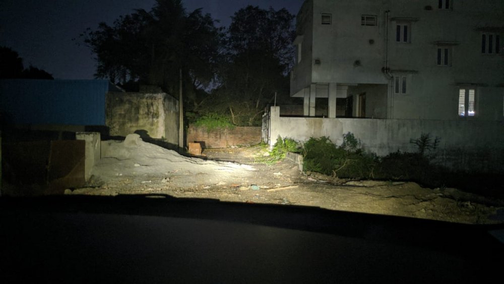

scene 3
Dark dead end alley. ambient light.
low beam
high beam
overall I could find good improvement over halogen bulbs! fingers crossed about its reliability.[:D]
