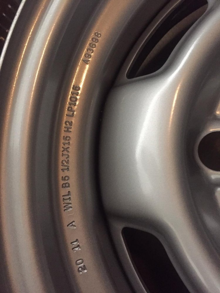

7. Managed to buy GYPSY rims (5 Pcs) for Amby in late December, from Dhanam Auto, CBE. They are TVS make ( Delphi, I think), Dhanam Auto vouched only these are availabe for couple of years, & my mechanic confirmed that also. Before that we checked in Maruti ASS. Not available in Maruti ASS, and they require Regn number of Gypy or Bring the Vehicle to Change.
Gypsy rims are the best looking wheels for Amby. They are made by Wheels India Limited (denoted by WIL), part of TVS conglomerate.
Thanks for info and refreshing the memory. I read it somwhere, but totallay forgot about WIL & TVS.

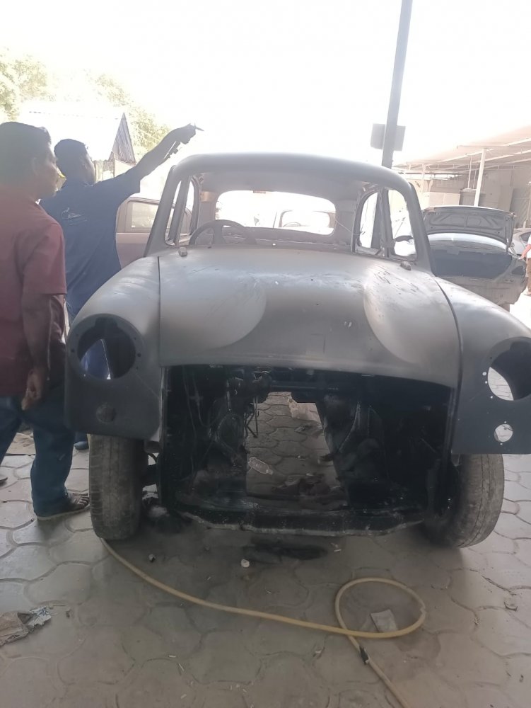

As my BIL moved to Coimbatore, in June, for Work (Work From Home being slowly lifted), visits to Erode workshop became scarce.
It already made already slow restoration process Even more Slow.
Finally I got my Independence day gift, from Paint workshop, after depending mostly on mechanic & paintshop for photos.
You can see the final color inside engine bay ( last two photos).
Mechanic had a discussion with Painter to remove the Battery tray & little bit of rework & repainting done towards end August.
Engine removed for Over hauling in June & service done at mechanic side.

Progress Update as on 15-09-2022:
Finally, Amby moving from Paint shop to mechanic shop for engine mounting works.
Engine work still in progress.
As per my mechanic, engine condition is good and lot of life left.
No Major spare changes, re-boring work is going on.
Let's pray everything will go well.
This clears all the backlogs in my amby updates. Will try to update frequently from now.
Below are the photos taken just before moving Amby from paint shop.
