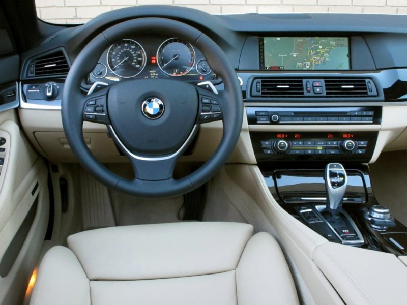

Nice Job Amby Lovers, The console and the Dashboard will look awesome im Sure !
Just out of curiosity -
Are you planning for your centre console to look something like this ? (Im unable to highlight or crop the centre console for some reason)
IF Yes , then paint the black part to Wooden/Faux wood, it will add more ambience

Fantastic RPM2500... Really superb judgement...
I was going through the BMW's and AUDI kind of thing (Not with their controls).. That is center part of console need to be straight. Tinker took my input and gave the output a nice one.
Can you update the wooden/Faux cost and where to do this.
I am having 2 options.
1.Rexin or leather.
2.Rexin with Wooden paintings.
Initially i planned for a seat height level console setup.. At this time we cant judge the seat positions, so only went with this height and set up.
Trust me i love that center console , never thought some one would actually do it. I had previously planned to do this on my car with Fibre but the painter gave me an idea of doing it with metal (he was a metal expert that's why.) However i opted out of it as Vitamin M was an issue [cry]
1.Rexin or leather.
If you have the money : LEATHER any day !
For Leather you have two options -
(1st Option) STANLEY'S - Should cost you somewhere between 28k-35k, this is by average of all the prices of work i have seen for a normal car.
For your car since you are customizing it you will have to check with them personally
(2nd Option) Karlsons - Karsons also is a premium leather upholstery bran second im quality to Stanley, they do a fantastic job too and a little cheaper than stanley too
This i guess is only available in Bangalore, however you can check this link and contact numbers for more info
Link - https://www.facebook.com/Karlssonleather
Tel - +918025216394
e-mail - contact@karlssonleather.in
If your going for rexin then do it at a good place and make sure to ask the dealer/shopkeeper to show you samples/pics of his previous work on other cars
It will also work out cheaper
You can check my ownership review link on painting of dashboard to faux Wood
http://www.theautomotiveindia.com/f...my-maruti-suzuki-esteem-ownership-review.html
I do know a person who does it in Bangalore, no idea in Coimbatore
If it all your amby parts were of plastic i would have advised you to courier it to me and would have got it done..... but from pics i see its all fixed so you will have to do it somewhere in Coimbatore itself
If your painter is creative and has lot of patience ask him to try it out,my painter did it for the first time and the finish is just SUPERB !
Hope it helps !
