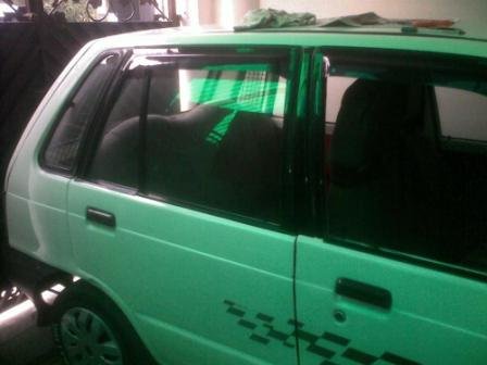

From many a days I was willing to blacken the B pillar. In the market they were demanding Rs 400+ for the job. When I asked the price of black sheet used for this job and number plating they were not ready to sell or asked Rs 300.
I had the black window film which I bought earlier. I used it and blackened the B pillar.
More pics will be posted soon.
Also bought these textured films these are used for mobile lamination.
