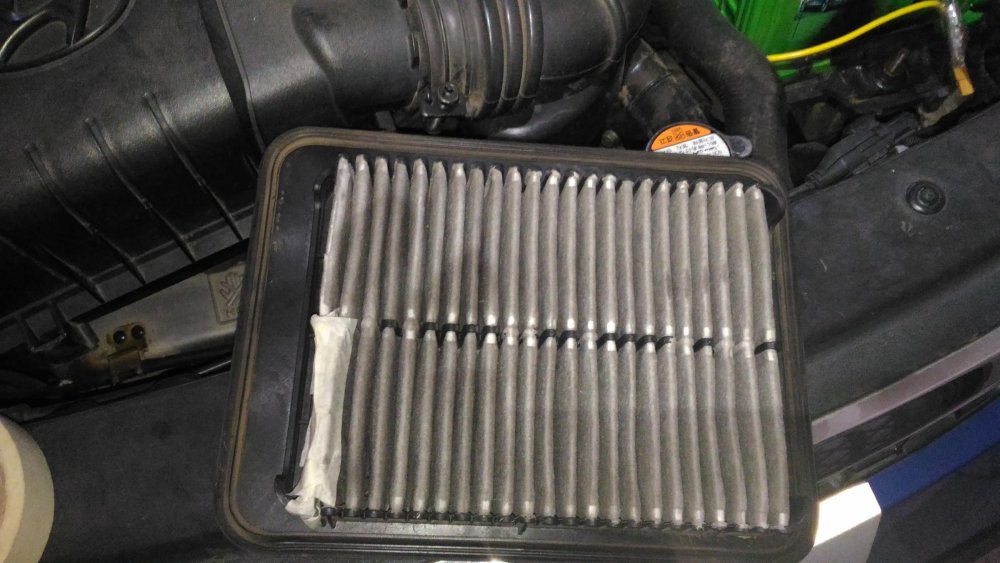

2. Noticed a tear (Rat?) in Air filter element-
My temporary fix-
