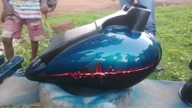

Make sure that design should be on entire tank, not only on the sides.
Expecting the final pics.
100% Accepted, will do that and have the pics updated...

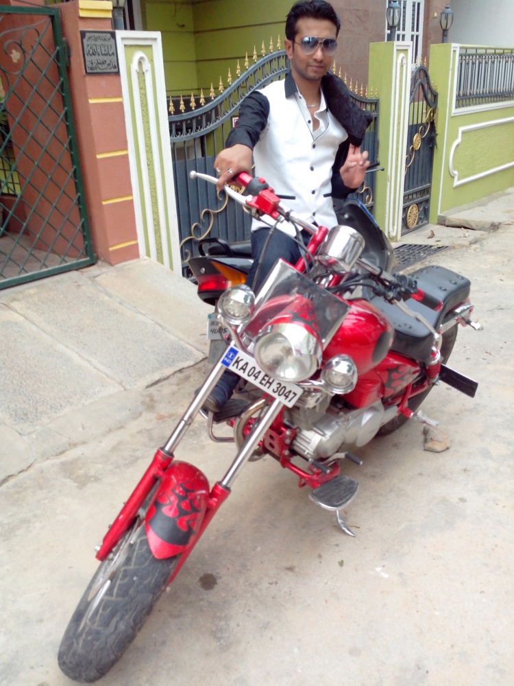

Had some pending job to be done as battery was large than the original one
So had been to Tinker and had to make a battery stand, Num Plates, Rear mudguard tail lamp had screws which started touching the tyre so had to alter a bit on that and he made clamps for the side sheilds as original one were not fit...
Now all that job is done and now bike is plated with Reg Num and wiring was poped out near headlamp as the Headlamp cone had small space and could not push the cables in and now thats taken care remote system is installed but the battery is not performing good..
Its a new battery purchased EXIDE and its not performing have to return and get that exchanged and then will have to finish the final job on Paint.. Polishing and touchup.. Then stickering...
Then its 100% complete.. Will update all pics..

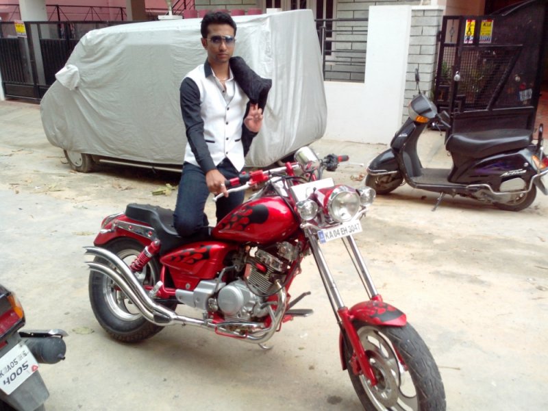

New Pics...

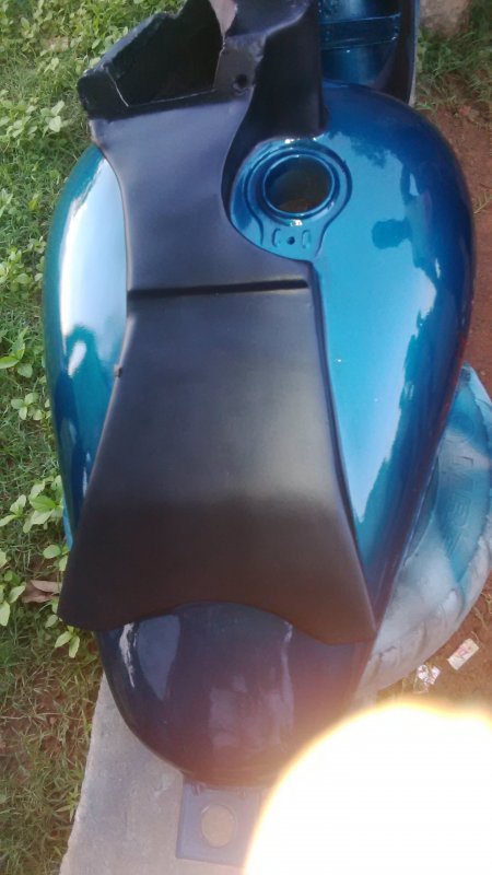

Here is the new update , the swing arm has been extended , reboring completed , starter fixed , fork height done to the requirement of my friend , now waiting for few parts to arrive ( sorry no idea on what parts ) , the handle that you see is not the one that will go on the bike its actually the old handle , he is planning to get a flat handle ...Sorry for the poor pics.
