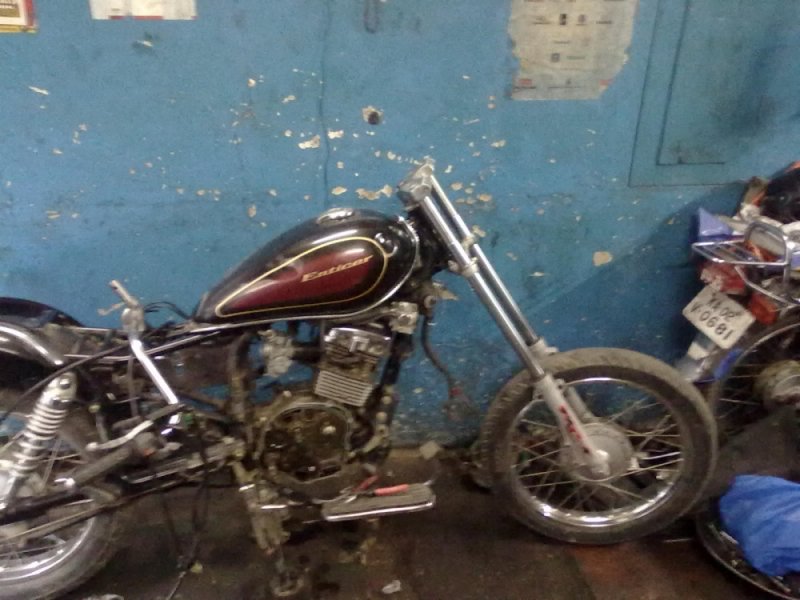

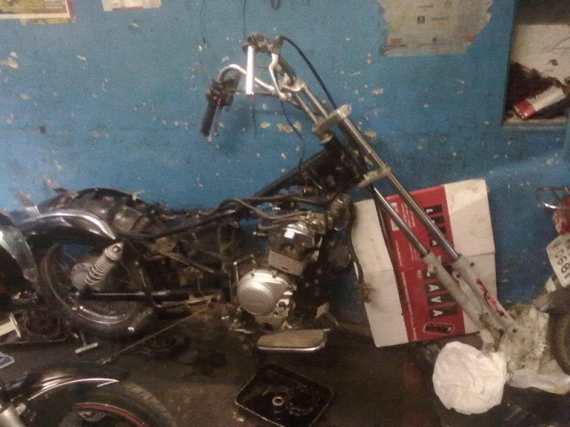

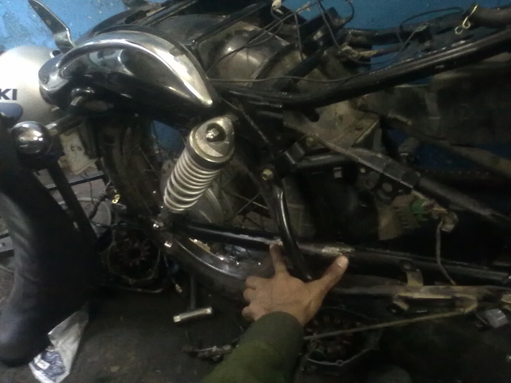

29

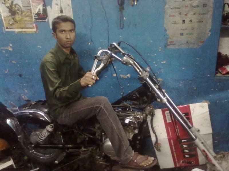

Here is the new update , the swing arm has been extended , reboring completed , starter fixed , fork height done to the requirement of my friend , now waiting for few parts to arrive ( sorry no idea on what parts ) , the handle that you see is not the one that will go on the bike its actually the old handle , he is planning to get a flat handle ...Sorry for the poor pics.

Sreejith : The swingarm job looks horribly done - a mere section welded onto the existing swingarm. What about the strength of metal/steel used? What about quality of welding job done? This is a VERY critical part and going by what I see, I would not dare touch this bike - in might just break into two pieces while riding because the torsional rigidity of the swingarm has been compromised due to welding on another piece to it and therefore the entire setup might not be able to bear the stresses that the original swingarm was designed to bear. Welding an additional section onto the existing swingarm is the worst way to extend the swingarm. The correct way is to fabricate a new swingarm of the desired length. I just hope for the safety of your friend. Fingers crossed.
I am waiting to see how well the rebored engine performs. Please keep us posted.
p.s. - Is that you or your friend sitting on the bike? Why so serious :biggrin:?

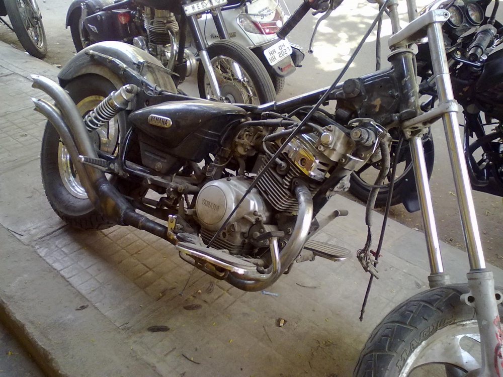

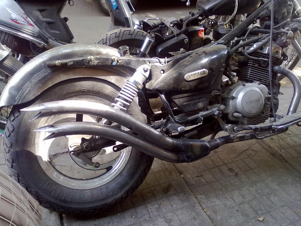

Sorry for the long delay guys just got an update , the work is almost complete , paint is pending , few bits & pieces here & there maybe work will be completed within a week or two (hopefully ), here are the few pics that I have received of the alloys , tire & the handle bars .The alloys on the front are 16'' , rear - 15'' , Rear Tyre: 150/90/15 Tubeless Tyre (Pirelli)...

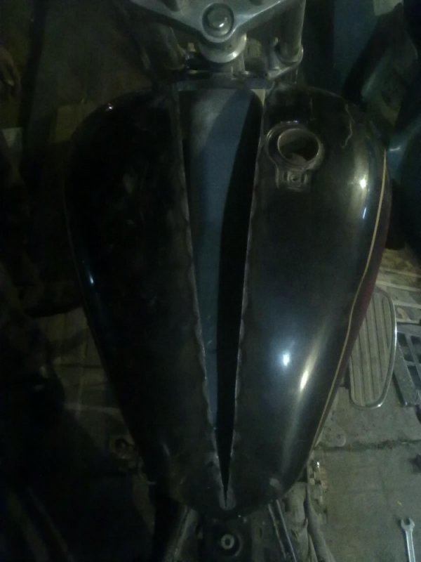

Update on the bike , will have the pics do the talking , the upgrade is still not completed , should be within 2-3 weeks @ the max . WIP
