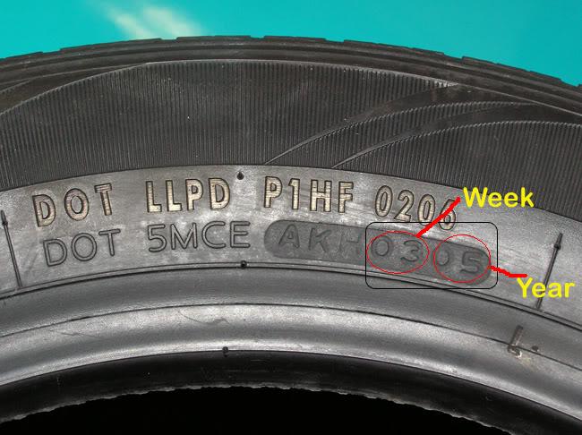

Most queries are answered. I am going to post a very important info so that you members are not sold old tires. You should understand that tires do have expiry date as they are made of organic material.
Whoops.
This is news to me.
Is that the month and year of manufacturing, or the month and year of expiry??

its just their company specific code. It manufacturing week and year and not expiry date as some of you are assuming.
PS: in above attachment its 3rd week of year 2005. Hence the tyre is made in mid Jan of 2005

Tyres do have an expiry date as it will break down after some years and there will be cracks in the tyre after it has passed its prime. It might blow out or fail if it has been on the shelf for some years and you have bought and put it on your car.
