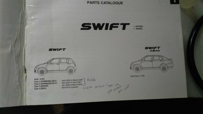

I just checked the registration card of my car. In that engine number starts with K12MN. So this must be a k series engine correct?

@Soyab_memon
1. K12MN without VVT April 2010 on wards
2. K12MN type 1 with VVT May 2011 on wards
3. K12MN type 2 with VVT Augl 2013 on wards
4. K12MN type 3 with VVT Feb 2015 on wards
-suryaputhra
Suryaputhra,
That's awesome information. Seems you have all the service manual with you. Do you have anu soft copy of the above parts catalog?... It would be very helpful in knowing the vehicle.
From where we can get this parts catalog? I had purchased my car second hand so i didn't get any such manual or catalog.
Thanks,
Soyab

Soft copies not available. I can give you part nos, you can buy from MSIL distributor for spares, if no stock you can give advance to them and order the books.
-suryaputhra
