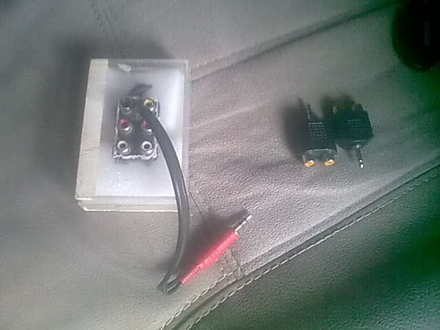

My question however is, the Audio part how do you connect it from a 3.5mm from the Laptop's soundcard Audio Out to the Amplifier ? Is there something else that I may be missing ?

Thanks zengetz for the compliment.You can connect the RCA cables to the computer's sound card by using an adapter.I've attached a picture of it.
The First one is a DIY adapter and I bought the other two from a local electronics shop for Rs 10 each[:D].
But it was a bit loose,so I had to use the DIY adapter and its working fine.
If you have a HU with AUX IN,you can connect the computer to the speakers through it.Using a laptop is better option as you can connect it to 12v(regulated supply) and you may not need a DC-DC psu.
