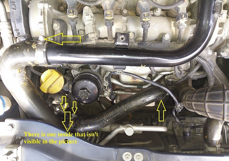

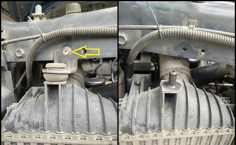

I remembered the DIY I had done on my earlier car i.e., Swift ZDi (2013 model) where I had performed the intercooler cleaning at home. The car had clocked 72,000kms after which I had attempted this DIY.
The front bumper removed to access the intercooler
The Intercooler
The marked bolt along with the rubber mount to be removed to free the intercooler from its position
After removing the top rubber mount, pull the intercooler up to free from the bottom mount
Intercooler removed - Front view
Intercooler removed - Rear view

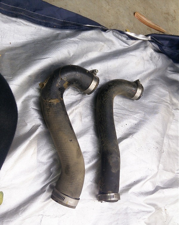

Piping to be removed for cleaning
Piping removed from the intercooler
Oil present at the base of the intercooler
Oil collected from the intercooler
After cleaning the intercooler post multiple washes with soap
Sorry to hijack the thread. [:D]
