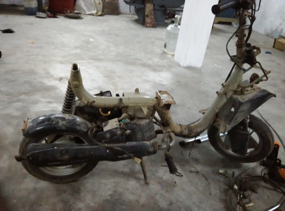

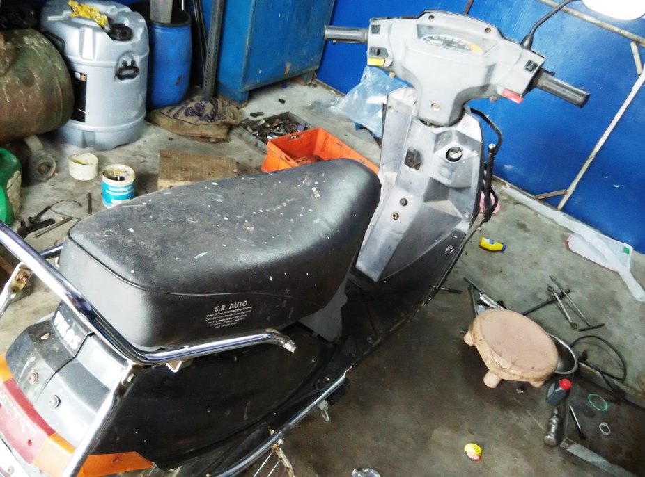

Base vehicle

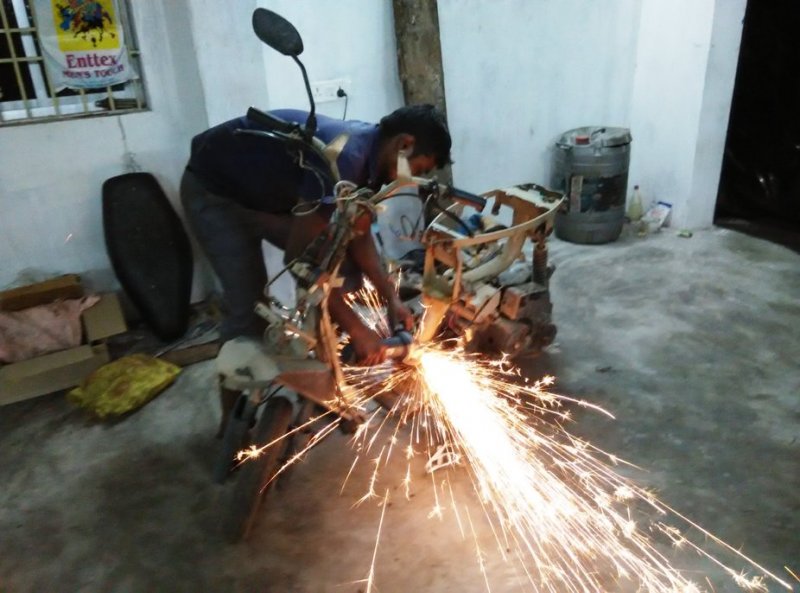

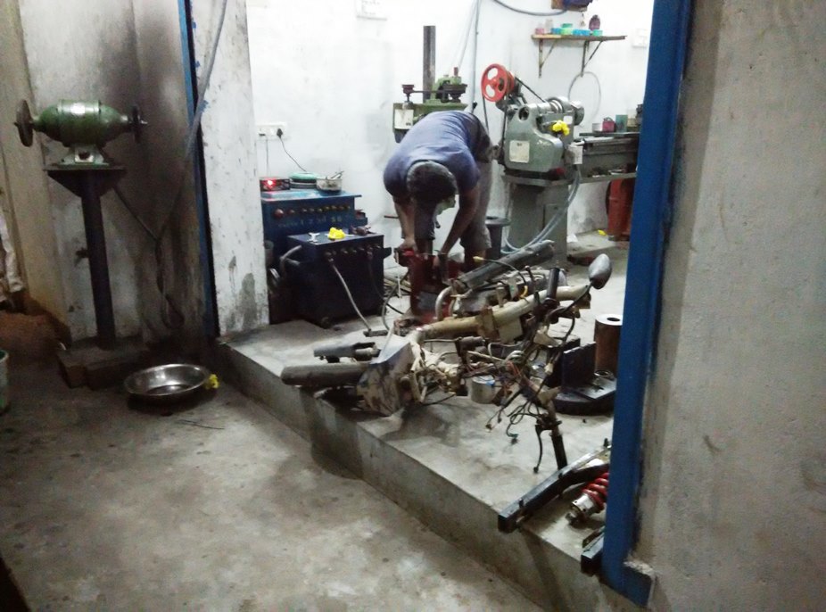

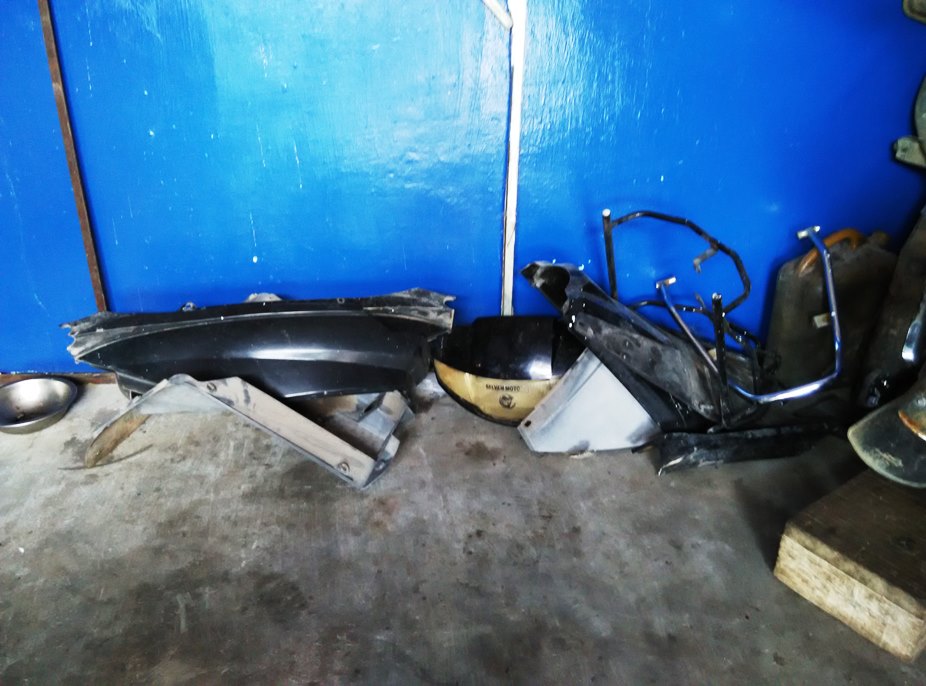

After 30 mins
Started chopping the unwanted bits & pieces

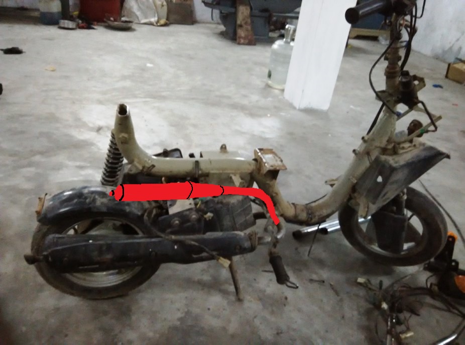

I think you should look to have the exhaust like the Bajaj Super, under body, as routing it like you have shone, heat shield for the seat, cables etc could be an issue, by the way is this scooty 2stroke or 4stroke?
I had this thought earlier, but the center stand positioning isn't supportive to have a Bajaj Super like exhaust routing. Anyways, let me reconsider if I could manage without bringing it near the seat.
