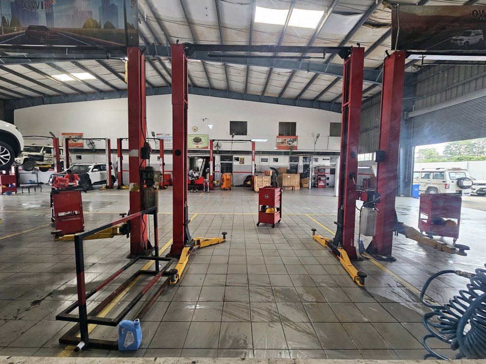

Finally reached the lift for washing

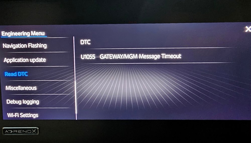

On checking the debug menu, found this DTC
Waited for a Day for it to start working but when it didn’t work even on the next day, disconnected and reconnected the battery which made them both come alive. Notice a couple of quirks.

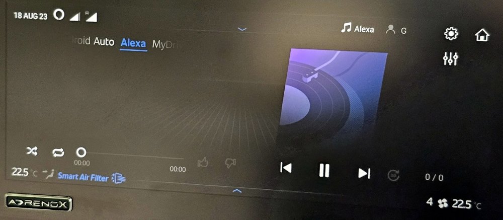

A. When playing songs on Alexa, the song plays as usual but neither song name appears nor the duration slider moves. Also the Previous, Pause and Next buttons are rendered useless.

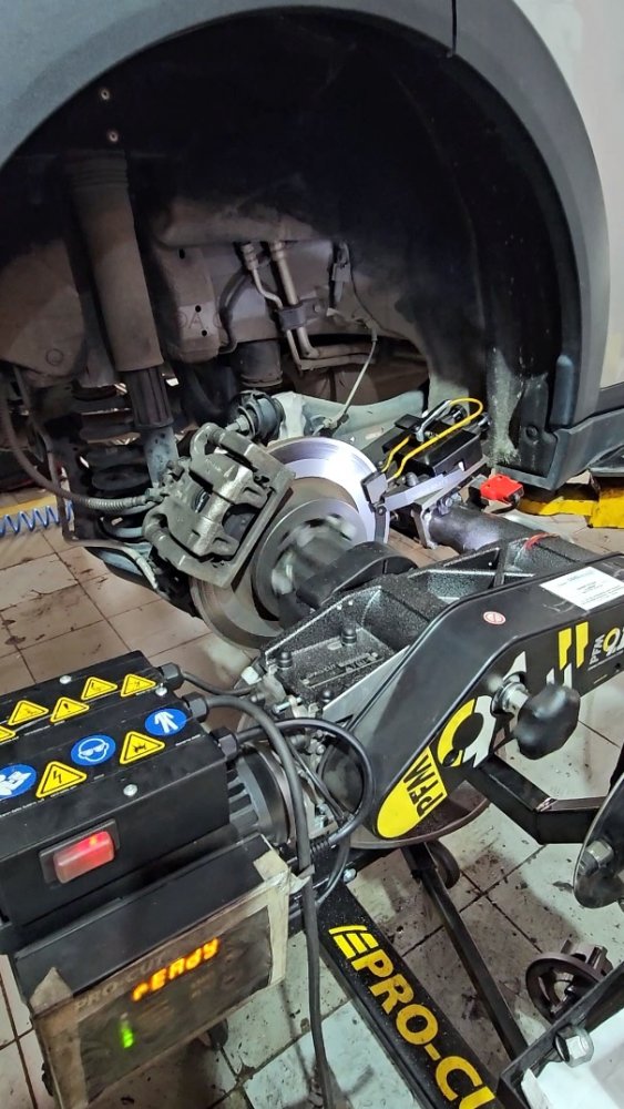

Procut in action for skimming the discs to clear out the minor undulations
Before
After

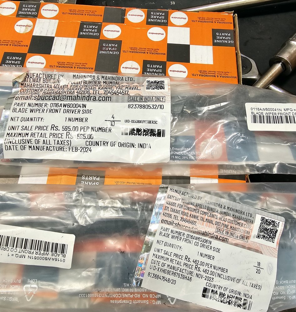

Front wiper blades also replaced

Saw the bays empty for the first time

(C) The AdrenoX system seemed to have entered some archaic software version as the Fun with XUV7OO tile was not displayed and the Apple Carplay tile changed to ‘Coming soon’
(D) After returning from another trip, it felt that there was some wheel-bearing or similar sound coming from the rear which was completely speed dependent. Demonstrated the same but I was surprised to find the blame being shifted on the tyres. The wear pattern was abnormal on 1 of the tyre which had saw-tooth like tread on one of the edge. Googled the issue the term ‘Cupping’ came-up which suggested shock absorbers as the primary cause along with worn out bushes causing damage to tyre – obviously the same was not accepted and just the balancing with tyre rotation (already done at 60K Kms) was done again as a stop-gap arrangement. The noise, though is still there, has reduced probably due to rotation of tyres.
At the workshop for diagnosis

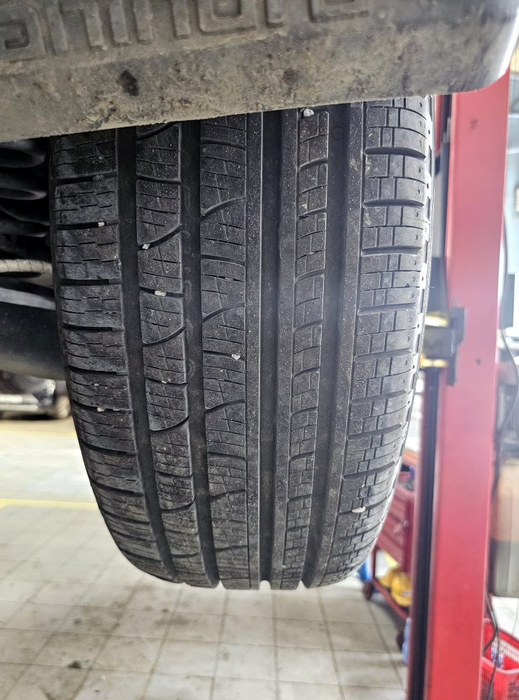

While no uneven wear caused by alignment is visible, the white triangular patch on the inside of the tread is lower than the darker triangular patch which is slightly raised which as per workshop is causing the noise
