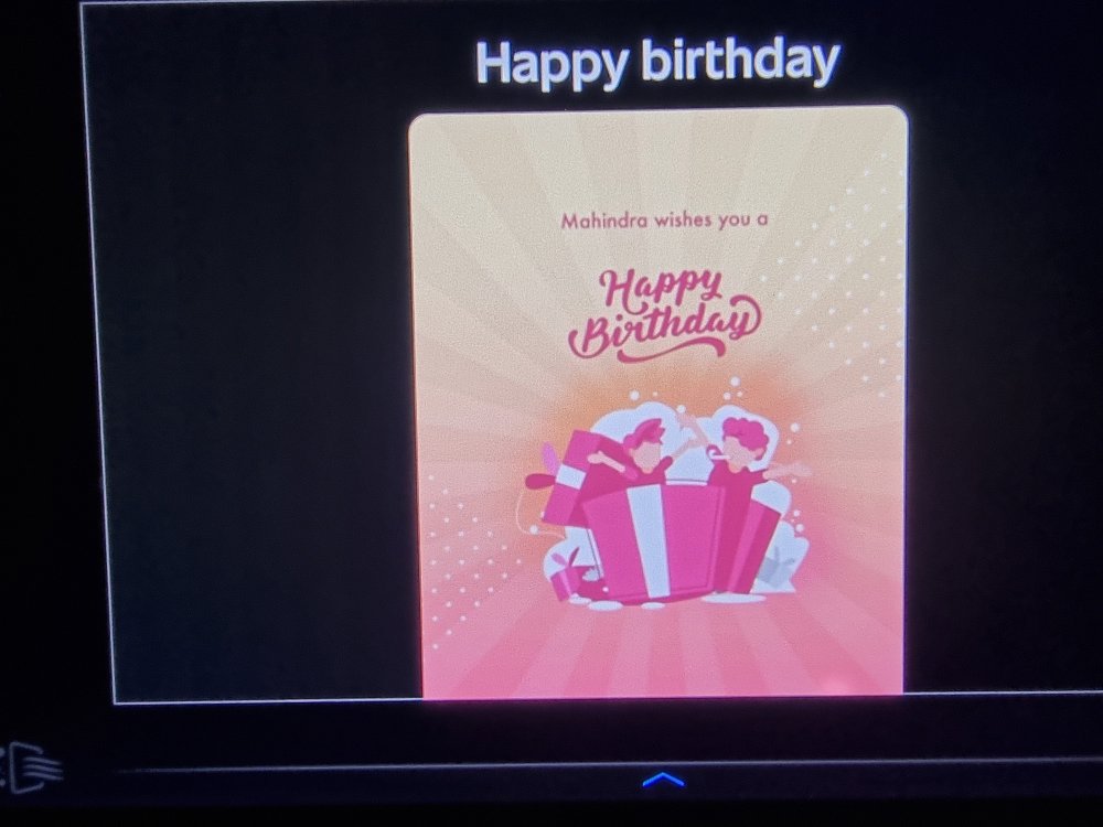

While setting-up the new system, found some interesting notifications.
Software showing System up to date despite not having the latest version of software
A sub-menu of Over the Air Surprises having Happy Birthday notification under History…
…along with a greeting
While it’s a nice touch, not sure from where Mahindra picked up this date as it’s incorrect.

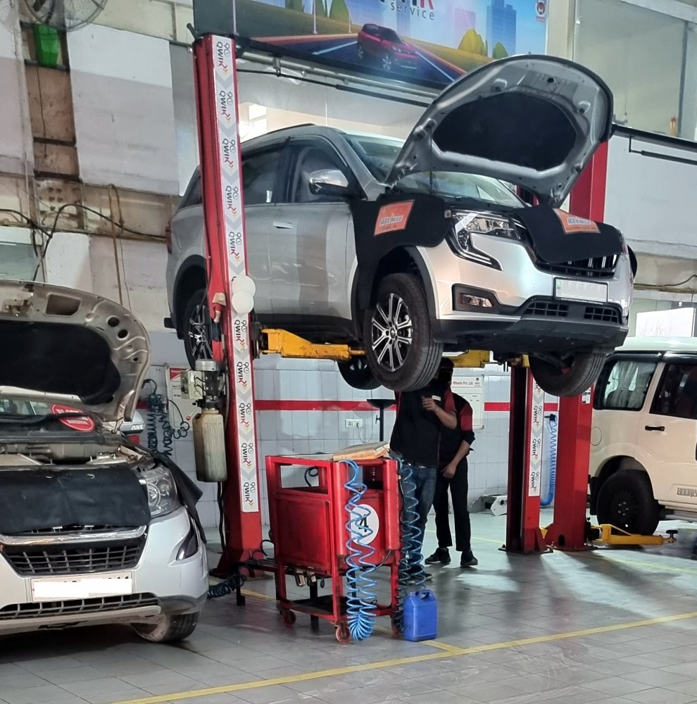

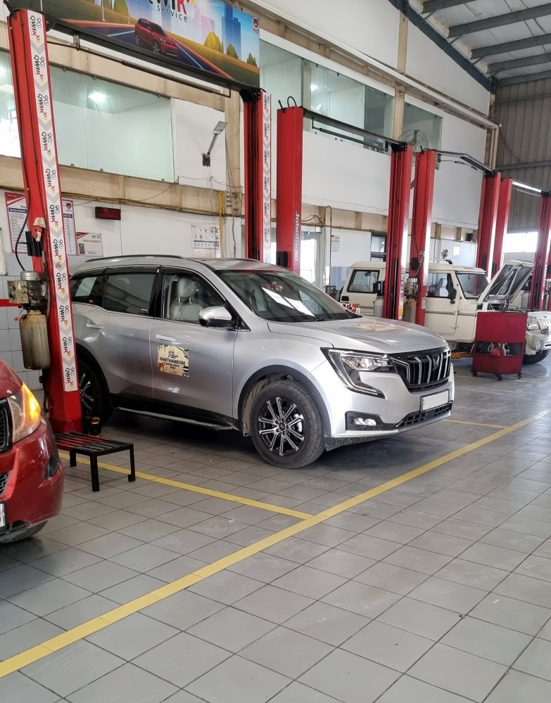

1st Service of 10000 Kms
Due to unplanned travel which came-up for next day and the odo already at 9500 Kms, checked with the local dealer Mighty Mahindra if they could accommodate the request for 10K service an hour later at 3pm. They were kind enough to accommodate the request and had a blazingly fast turn around of just 2 hours which included some minor jobs.
Engine Cover was rattling and it was fixed properly. Tyre rotation with steering calibration addressed the issue of steering feel which was different since the Lower Control Arms replacement. Engine Oil, Oil filter and cabin air filter were replaced while cleaning the Engine air filter. 6 Liters of DEF was also added bring the total service cost to Rs. 4,471/-. Including the previous DEF top-up of 8 Liters (Rs. 977 including filling charge), the total DEF consumed was 14 Liters (Rs. 1631 total expense) for 9500 Kms leading to approx. an average consumption of 680 Km/L and additional cost of Rs. 0.17/Km.

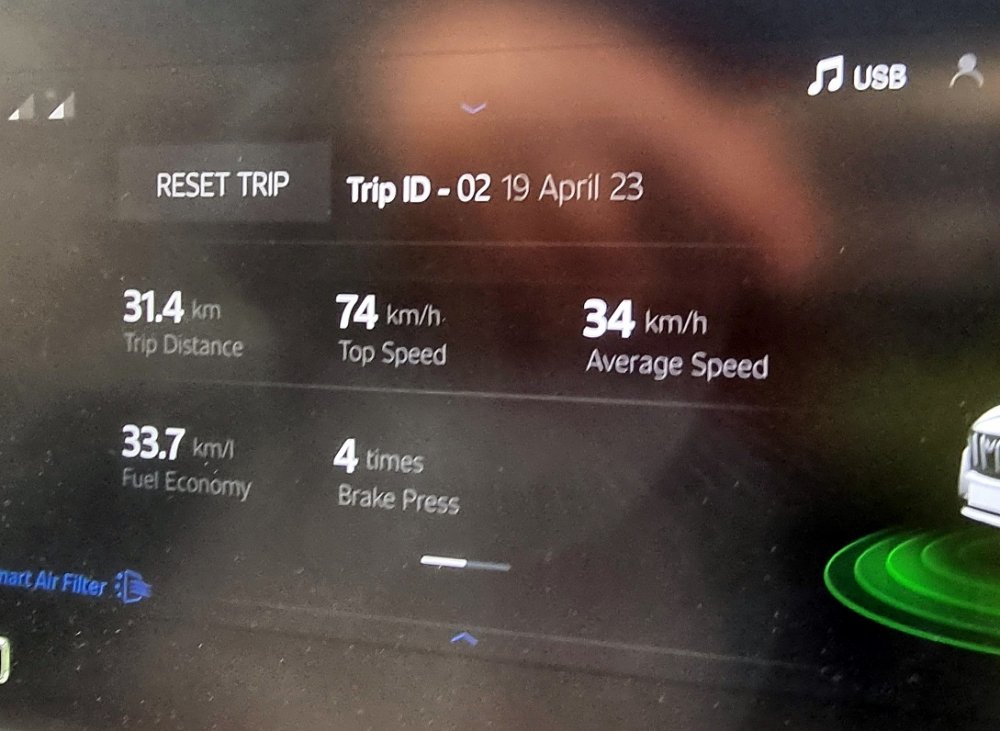

Experience from covering 3500 Kms in just 10 days
Certain circumstances required taking 2 round-trips of around 1400 Kms each split equally over 2 consecutive days just 8 days apart. Including some work related travel, it meant covering a colossal 3500 Kms in just 10 days post service.
An interesting behavior I noticed on my highway trips is once the speed stabilizes to anything above 60-70 Kmph after starting from even 2-3 days of pure city run covering 100 Kms at max, there is a considerable drop in FE (as noticed via the instantaneous gauge) for the first 20-25 minutes. Post this only normalcy is restored and the FE jumps back up by 2-3 Kmpl. Looks like automated DPF regeneration happening in the background to clear all the soot accumulated from the city runs. Wish the Information skin on the instrument cluster gave some real information related to what’s happening with maybe some advanced gauges for Soot level & regen state, Turbo Boost, Battery Voltage, Transmission Oil temp., etc. With the Android based implementation, would have been great to just have Torque Pro installable on the center screen for all this information and more.
Trip stats post fill-up after the first day run - amazing frugality
