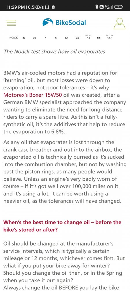

Since the oil consumption issue is not resolved, I'm thinking about using a thicker oil. This is a classic solution which works. XW60 oils have been used by a few abroad and reported positive results. But this grade is not available in India. The best bet I have is 20W50, which is the recommended oil grade for Duke 200.
But, this makes me think. Why did KTM specifically recommended 15W50 for the 250 and 390 while they were already using 20W50 for the 200. Wouldn't it have been easier for them to have just one oil grade for all the bikes?
From my past experiences with using slight deviations from the recommended oil grade, I have not noticed any issues.
This also makes me remind of what happened with Maruti Suzuki. They used to recommend 5W30 for K12 engines. Later they changed it to 0W20 and then to 0W16. But the ASC fills 5W30 most of the time. And with these ASC, it's not like we can confirm they filled what they billed us for or not.
Oil consumption is normal is newer engines today.
BMW for example, has said that some of their engines can consume up to 1 quart of oil for every 750-1000 miles driven and that it’s normal.
That's 1L per 1200km is normal!
The Duke 390 engine is a highly stressed unit and with a compression ratio of 12.8:1, it runs so hot. I guess the oil would get sucked past the cylinder walls and rings when ridden hard.
