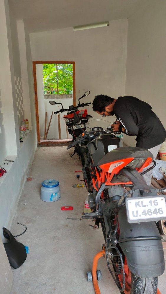

My Duke 390
Drilled out the broken bolt using a 3mm bit and installed a new crash guard.
The new crash guard did not align correctly with the screw holes at first. There was a few mm difference. I had to bend it using a car jack to make it align correctly with the chassis.
While fitting the crash guard, I saw the radiator bleeding screw of the bike and thought to loosen it slightly and see if there was any air in the system. I have never opened this before in my life even while changing the coolant.
I only came to know about this bleeding screw recently when I was reading the workshop manual before I changed the coolant in my friend's RC390.
After I loosened it and the coolant started dripping out, I tried to close it. Lo and behold it keeps on spinning forever. There was barely any thread in it. I was dumbstruck by this!
How in the world can this happen? I was so disappointed in myself that I touched it!

RC390
After the coolant change in the RC390, my friend reported some burning smell. Turned out to be the drain tube from the EVAP canister that was rubbing with the exhaust.
There was supposed to be a clip in the fairing to hold it. But that clip was disappearing from the fairing(fallen off?). So, we never tucked it in anywhere.
This resulted in the tube getting burnt. Tried to get a replacement from the service center and as usual, it was not in stock.
Cut off the burnt part (and about 20mL of petrol fell down) and tied it to the frame with a zip tie away from the exhaust.
I have no idea why KTM would put a fuel drain line right over the red-hot exhaust! In my Duke 390, this is situated at the right side tank cover, far from the exhaust.
