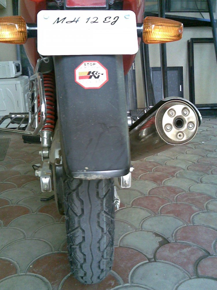

All the modifications on the bike except the handle bar & rear tyre fitting were carried out by ME.The toughest of them all was getting the air-fuel mixture right.I literally used to do countless no of runs on highways with a screwdriver in my pocket.The screwdriver was used to turn the AIR SCREW which even the service center people were reluctant to do.
1) K & N Filter (rc1060) - Went in at 2700kms somewhere in Jan-Feb 2008.Filter was fitted in the stock air filter box & it was kept open.
2) Pilot Bulbs & Headlight Bulb - The stock yellow ones were replaced with white ones.
3) Jetting 1st time - The new size jet 130 (stock is 125) went in at roughly 5600kms.Some guy in GOA made it so i had get it from there.
4) ROOTS Horns (Skoda Horns) - The stock one was so poor that it dint even suit a cycle.So was replaced with the skoda ones.A metal piece to hold the horns,a relay & little wiring were the only things required.
5) Neon Light - Looked good.The electric circuit was fitted under the seat,switch inside the fairing.Only the round neon tube was exposed to water,air,dirt.I had 2 such round tubes which lasted for 7-8 months together.Then i was bored of replacing it again so removed all the things.
6) Rear Tyre changed - 120/90 Dunlop Monster (Stock size 100/90).Awesome gripping in wet as well as rough surfaces.Handling totally reached to a new high.Top Speed,pickup,mileage reduced a little.
7) 3 Piece Handle Bar - Though it looked good it sucked to the core.Went back to the stock within a month.If i would have had that handle bar when the bike slipped at 80km/h & went screeching sideways on the cement road it would have broke into so many pieces & the faring would have broke.
8) Jetting 2nd time - This time the 130 size jet was enlarged to around 135 & put back at around 10K kms. The earlier size jet dint feel sufficient & the engine was running lean when the filter was fitted onto the carb directly.

I used to & still do open the bike hundred of times in my parking.People watching me will surely think i am crazy.
Opening the Neon lights to remove the electric chip,soldering wires.The green chip was fitted under the seat to prevent it from water,mud.
Neon Light Fitted
This handle bar really felt sick.
Dunlop Monster 120/90
White Pilot Bulbs & Headlight Bulb
Had Removed the fairing to rewire the horn & neon light switch properly.
Had A Chance to use P220 for a month.Its a equally great bike,but for me it always will be a Karizma.
