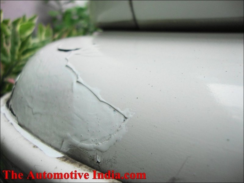

Corrosion is biggest enemy of any car.
Pay close attention to small dents and scratches, they may help to reveal an untold story.
Avoid models with uneven panel gaps and dents.

Marks of an effort to repaint.

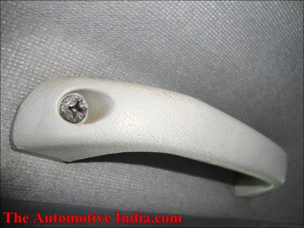

Now, It’s time to examine rest of the interiors, sit on all the benches, front as well as rear, if they wear the seat covers, remove them and check for any bad stains, ashes or burn marks. Otherwise, if they are alright, a simple dry-cleaning would be enough to bring them back to life. Remove the foot mats and carpet to detect any corrosion, here the magnet method will again come handy. Open and close all the doors, and roll up and down the windows at least a couple of times to verify their fitness, not to miss the boot either, which must have at least the spare wheel and jack resting intact, However, with some utility vehicles like Tata Safari and Toyota Innova, spare wheel is fitted on the rear door and under the car’ rear end respectively.

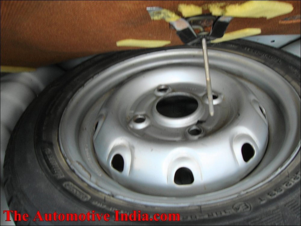

Spare wheel should be intact along with Jack.
