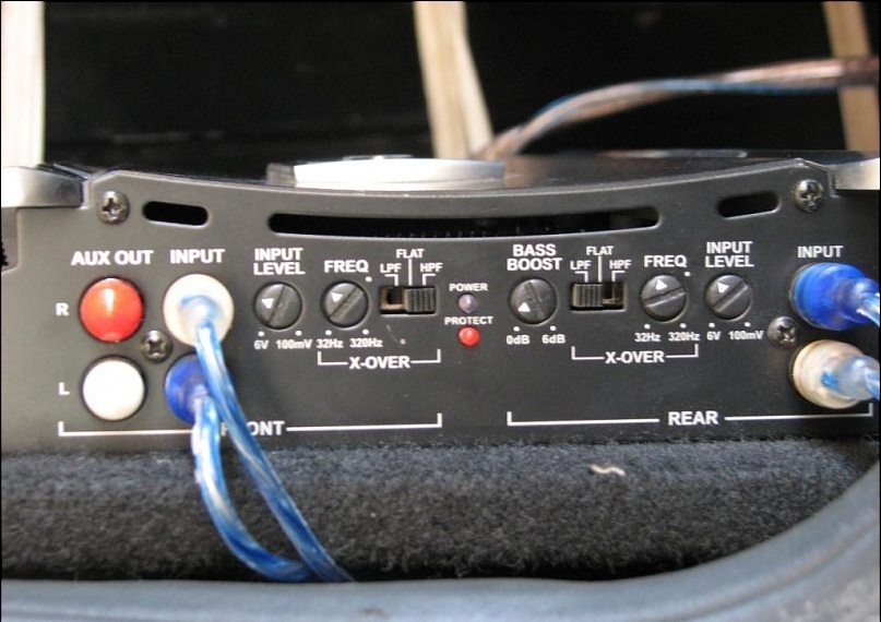

In a typical speaker/sub set-up, we HPF (high pass filter) the components to divert freequencies above the filter we have set and LPF the sub so it receives freequencies lower the LPF settings. A typical example is HPF and LPF at 80Hz.
Now, if you just amp the 4 speakers (components and coaxes) and you HPF the fronts so you'll miss out on the bass where as if you run FULL (also known as FLAT) then your components would produce decent amounts of bass too. Co-axials would anyways produce all notes as they don't have a X-over.
Just for reference I am attaching a pic to show the rear of an amp, well not THAT rear... [;)]
Here you can see LPF-FLAT-HPF. On this switch just keep at FLAT.
freakdude.

This explains a lot buddy.. Really helps.
If I understand you correctly, when I amp the components & co-axials, I leave both the switches to Flat..
I will go back home and check my JBL Amp for these switches.. [:)]
EGGJAACTLYYY!!! [glasses]
This setting shall remain only till you plan to add a sub in which case fronts will be HPFed and sub will be LPFed.
