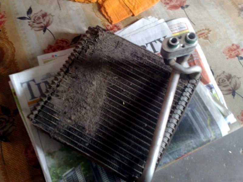

well a couple of days back , the i10's AC was dead. no cooling nothing but only 1 vent was blowing cool air.
last year got the AC serviced from a local mechanic for some 1000 rupees. he filled in the gas without vacuum , cleaned the air blower.
after a year it died so thought of getting it checked with the company. went to the SC in the morning and AC coil had a leak so it needed replacement so replaced it [:D]
Total Service charges - 3720 for the AC checkup level 4 and the AC coil.
The Bill.

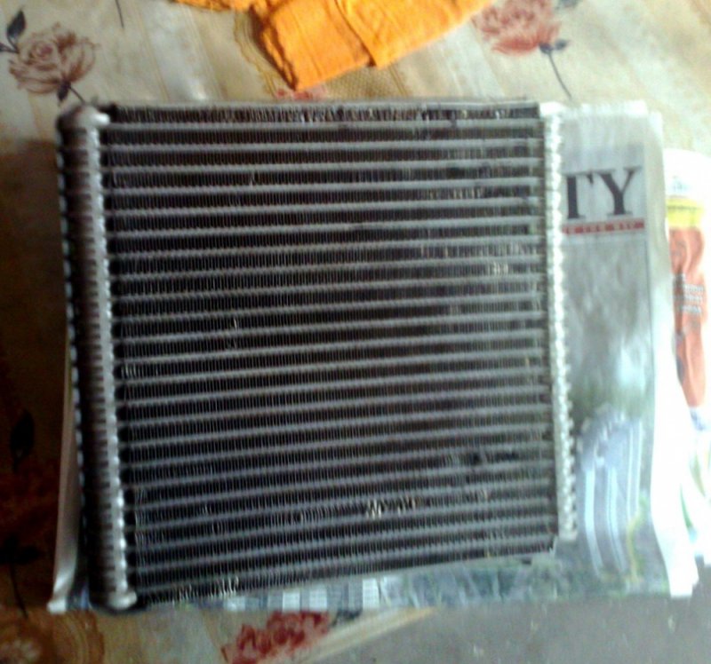

The Affected part.
the back of the Affected Part.
so i guess it needed replacement. and AC is good as new [thumbsup]

do you use the ac on fresh air intake? Yeah why not get the santros ac serviced as well. I don't get it how come the service package is cheap but the evaporator on the other hand is costly as well as the compressor ?

i asked you as the evap is plugged with dirt there.

ok tell me one thing. what passes through that evap ? some liquid or gas ?
if liquid then maybe because of the leakage it attracted dirt [confused] if gas then i don't know why that much dirt settled there.
Sep 4, 2011
3,669
315
Mumbai MH01/MH46
the evap is sealed the refrigerant passes as a liquid as it expands the gas evaporates and brings down the temperature in the coils which makes the air around cool now water condensation forms on it as its cold. so dirty gets accumulated on it. As well as gas even compressor oil circulates if theres a leak the oil and gas leaks and that oil marks help detect the leak.

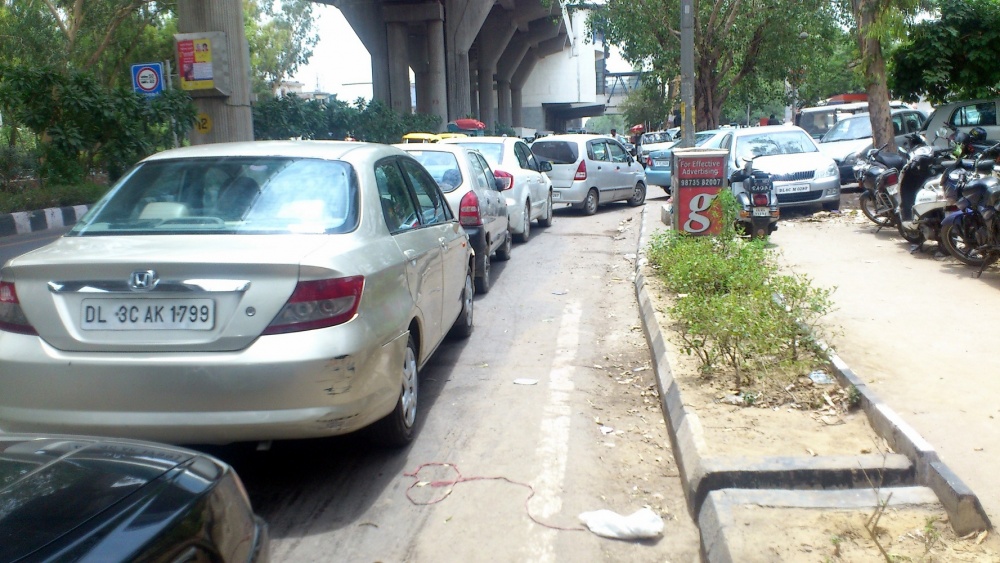

if you guys don't know just yet , there's a pollution check drive going on in delhi , so get your PUC certificates asap to avoid challan
went today for the PUC certificate. it took me 1 hours 45 minutes to get it done. every petrol pump was crowded. some pics.
the red i10 is mine [:D]
