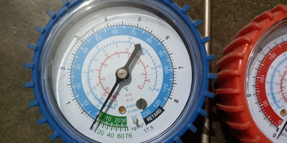

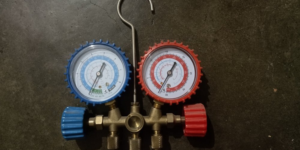

I believe there are excellent AC mechanics in Kerala and in Thrissur with good equipment. All over the India most of the AC equipment shops are owned by Kerala people.
After replacing the evaporator coil follow below process.
1. Try to active vacuum near to 30 PSI.
2. Check for vacuum leak. If guage needle stand still even after 30 mins. There will be no leak..
3. Blue color guage is Lo side final pressure should be between 40 to 50 PSI
4. Red color guage is High side final pressure should be between 180 to 220 PSI
5. Stop filling Refrigerant once you achieve those pressures.
