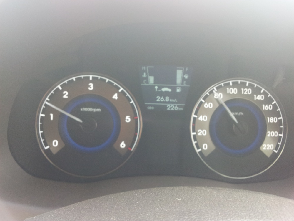

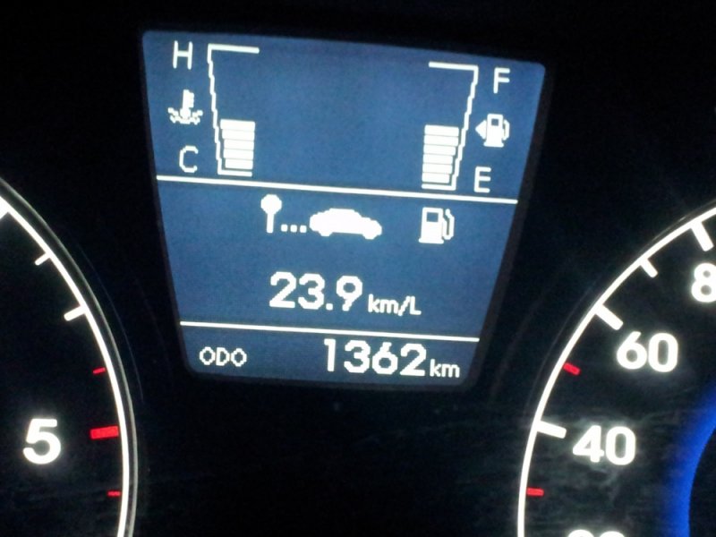

Covered 1520km till date with one trip to Delhi-Gwalior-Delhi. Drove on Yamuna Expressway at 1500rpm at 80km/h speed in 6th gear imagine what I got in return from this Jewel. a superb 26.9 km/l mileage awesome. what else you expect. do you think it can go better.
My till date Average Fuel Consumption is around 20 it includes both highway and city driving in Gwalior.

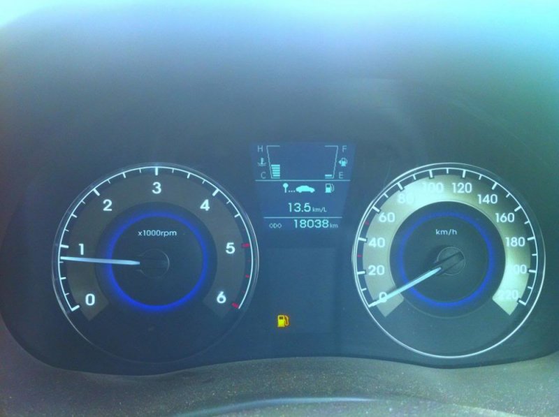

1. 8th Month Update - Clocked 18000 KMS
2. Engine - Smooth and no issues
3. Clutch was a little too tight - rectified with Clutch bleeding
4. One major Accident on a trip - Broke my bumper, damaged Radiator, Headlight.
5. Minor Scratches.
6. Front Bumper is the Worst thing this Verna has, Very very sensitive.
7.Mileage is as good as the new Verna.-Dont Expect to give ggood mileage in Bumper to Bumper Traffic - If your mileage is bad, Try a highway trip, you will know its awesome always.

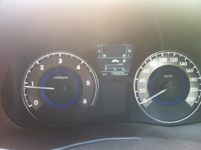

Its exactly 9 months of ownership and my car has clocked 19500 KMS.
Update:
1. Minor Clutch noise - To be rectified
2. New Suspension Upgrade notification received at Service Centers - To be upgraded with new coils in phases - Confirmed
Other than these, there are no issues. Its ready for the 3rd service.

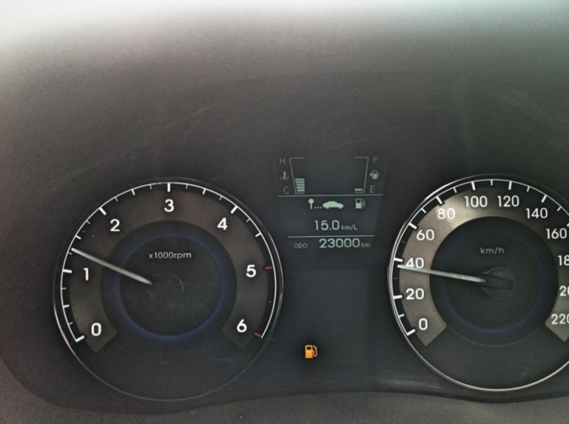

One year update - 24000KMS
1. 3rd Free Service - Finished the 3rd FS in April 2013 at 19924 KMS. Total amount was Rs.5500+
2. First Anniversary update - Clocked 23000KMS on completing 1 year. Lot of driving.
3. Front coil spring changed under warranty, now the GC is lot lot better.
4. Keys replaced under warranty - Was not working properly. Now Butter smooth.
5. Clutch Releaser Bearing Replacement - Lot of Krrr Krrr noise which shifting gears was there, told the ASS team and they removed to find it damaged. Replace under warranty. Now clutch is fine.
6. Rear passengers had a bouncy ride on highway, got the rear suspension upgrade to stiffer coil springs under warranty. Now with the new coil springs the car feel more planted to the ground.
Overall a great car till now with minor tweaking, mainly because of Bangalore's road condition, Traffic etc.
