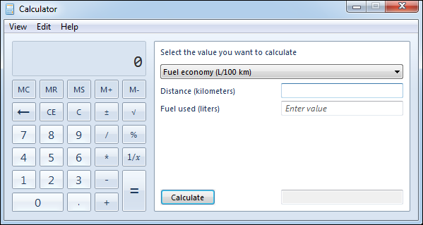

The calculator function in Microsoft Windows offers facility to calculate mileage in MPG as well as L/100 Kms. Go to View > Worksheets > Choose a suitable option.

Just now calculated 120 Km in 30L.It is giving a whopping 25 Km/l with full tank.This is as per Calculation in Mileage in Calculator of Microsoft Windows.Will be trying in my Vento after highway trip and a city run.
