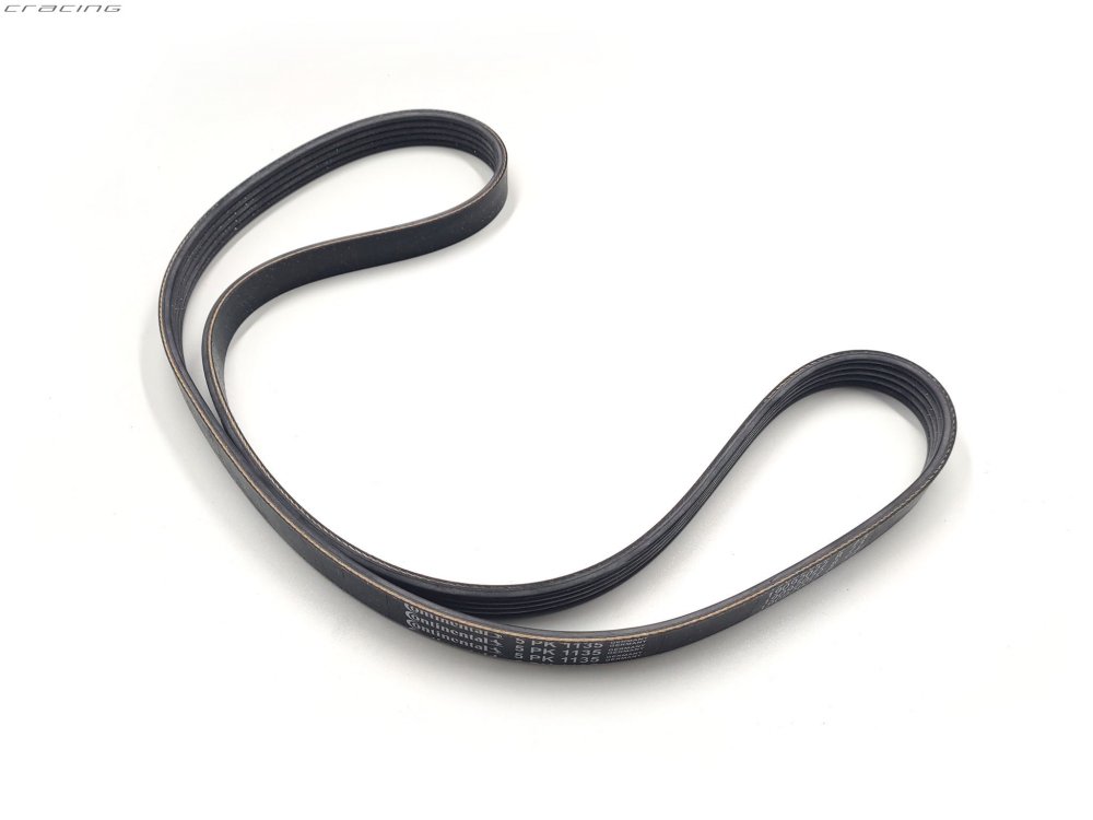

Serpentine Belt Replacement (September 2023):
As vehicle gets old, it is important to check and replace critical rubber parts such as serpentine belt, timing belt, bushes, dampers, hose pipe, dust boot and etc. These parts get dry rot overtime and start to break apart. Some might only make noise and/or vibration but others can cause serious failure or damage to other parts.
Serpentine belt is used to drive multiple peripheral devices such as an alternator, power steering assist (only in some cars), water pump, AC compressor & etc. It is a reinforced belt designed to last 1-1.5 lakh kilometers or 10 years. Common issues are squeezing noise and/or slipping due to loss of belt tension and peripheral devices will not function properly.
Mine didn't cause any serious issues but the belt had minor cracks and worn down v-ribs so it was time to change it. My car has auto tensioner so no adjustments required and it only takes few mins to replace the belt.
Boodmo has stopped selling OEM Honda parts and ASC doesn't give parts over the counter. This is really a deal breaker for those who are considering buying Honda cars and me too in future. Anyway, OEM belt (38920-RB0-004) spec is 5PK1137 (1137mm length with 5 ribs) and I found the nearest size (5PK1135) from Continental brand. There are other brands such as Gates, Optibelt, Fenner, Pix but they were plus 3mm to 8mm (1140, 1145). Auto tensioner has spring inside to put pressure on the belt and it will also lose some tension after many years so I thought a slightly tighter belt will compensate.
Product Link: Boodmo (Contitech 5PK1135 Multi V-Belt)
Product Pictures:
Replacing the belt is pretty simple and only 19mm spanner is required to lift the auto tensioner. Although it is possible to hold the spanner in one hand and remove old belt but fitting new one will be tricky so I used a zip tag to secure the spanner to nearby bolt and then work on routing the new belt. I also had to remove wheel well cover for easy access. Here is a video on how to replace Serpentine Belt on Honda Jazz which is very similar to Honda City. I didn't had to remove the wheel though, just turned the steering to far right.

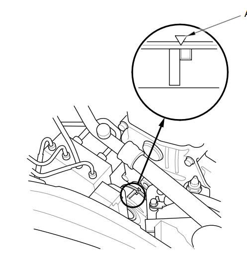

More about belt wear indicator on Auto Tensioner:
Most of auto belt tensioners have an indicator to show the condition of belt; whether it has become loose or worn down (thickness of V ribs) and also spring tension. Markings may differ with manufacturer so here I will be giving details for my car only (Honda City/Jazz/Fit)
Normally the pointer should be in-between the tab and indentation like this:
----V-----
|....| |__|
|__|
If the pointer is all the way to left then the belt is loose or worn and requires replacement. Using loose belt will also cause this:
V---------
|....| |__|
|__|
If the pointer is all the way to right then the spring inside auto tensioner has lost the tension and requires replacement. Using tight belt will also cause this:
---------V
|....| |__|
|__|
Here is guide on how to test auto-tensioner using vise and torque wrench.

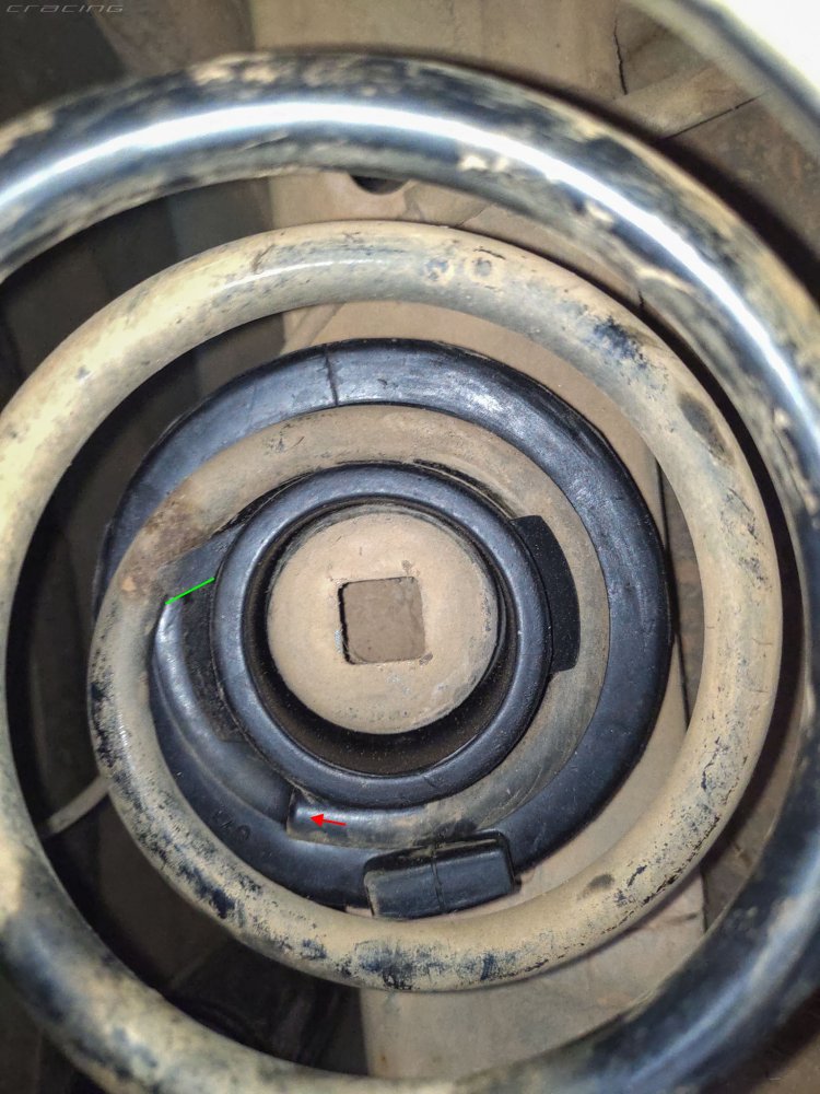

Finally my car is leveled and doesn't look/feel like boat. [:D]
Few days ago I went to a known garage and got the old pads replaced. They were crushed and degraded badly. Even though new pads are aftermarket, they are designed exactly same as OEM pads. However, the mechanic didn't align the pads and I didn't get a chance to check everything myself (Was afraid to go under the lift). It may not cause issues but you know things should be installed properly and that was bothering me so today I jacked the car, removed bottom shock absorber bolt and aligned the pads. The spring end should touch the tab/stopper made on the pads (Upper and Lower). I had to tied the spring with jute rope so it doesn't expand and pads turn freely. Now everything feels perfect and there is no knocking noise or stiffness like I had with buffer pads.
Spring end (Red arrow) should touch the tab/stopper (Green line) made on the pads. This is upper pad and should be done same on lower pad. There are also yellow, green markings on the lower pad and spring for alignment.
Jacked the car for aligning spring and pads. I had to do it on both sides. However, removing the springs is not possible or too risky with single sided jack so better visit garage with car lift for replacing pads.
