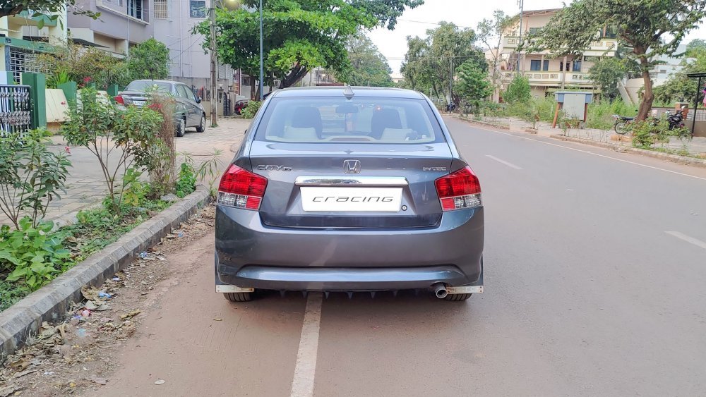

7 Fin Rear Bumper Diffuser (November 2022):
I wanted to put this plastic diffuser to improve the rear aesthetics of my car and horsepower (Just kidding!) but could only buy it recently from Autotrends online store through my friend (Most of the time it will be out of stock). It cost me Rs. 790/- and the quality is pretty good though the installation was tricky for my car. There is a tow hook which was obstructing so I had to heat the middle fin using hot air gun and press it. Initially I though cut out was needed but not really. As you can see in the below picture(s), the bumper is just two inches on the bottom and then there is about 5-6 inches gap till stepney case so after installing the diffuser, the gap has been almost filled. Pardon for not taking pictures before installing the diffuser.
Link to product: Here

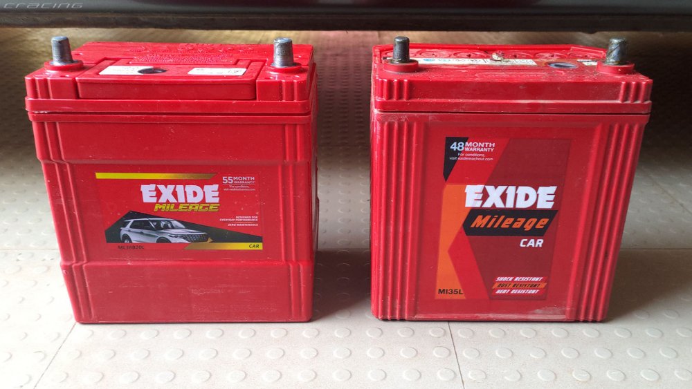

Exide Mileage ML38B20L 35AH Battery (December 2022):
First battery (Amaron Black) which came with car lasted 5 and half years whereas second battery (Exide Mileage) broke the record with 7 and half years! Last week I visited ASC for suspension checking and there it was having trouble starting so SA asked me to get it replaced from us but their quote was higher then battery dealers hence I refused to buy from them. I took the delivery in the evening and went straight to Exide dealer to get a new battery. Cost me 4.5k without giving old battery (I needed it for DIY purpose). I hope the third battery lasts 10 years! [:D]

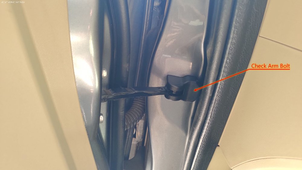

Door Weather Strips Replacement (August 2022):
All the rubber weather strips on the door and opening were worn so it was time to replace them but they don't come cheap though. Tube like strip for door edge cost Rs. 500-600 per piece and ~1k for door opening because it made of rubber with steel armor. Total cost for 10 rubber strips was 7.3k and I bought them from Boodmo.
Replacing rubber strips from door opening was quite easy; simply pull out old strip, align new one correctly and press it all-round. However, the tube like strip on door is little tricky and more effort The strip is fixed using plastic plugs all-round the door so we have to pull it out using pry tool or nose plier and also remove check arm bolt to take out the strip. Once it is out, we can fix new strip using provided plastic plugs (on top there is a groove to hold the rubber) and finally reinstall the check arm bolt (Apply medium strength threadlocker). To replace all the rubber strips I have taken two days time.

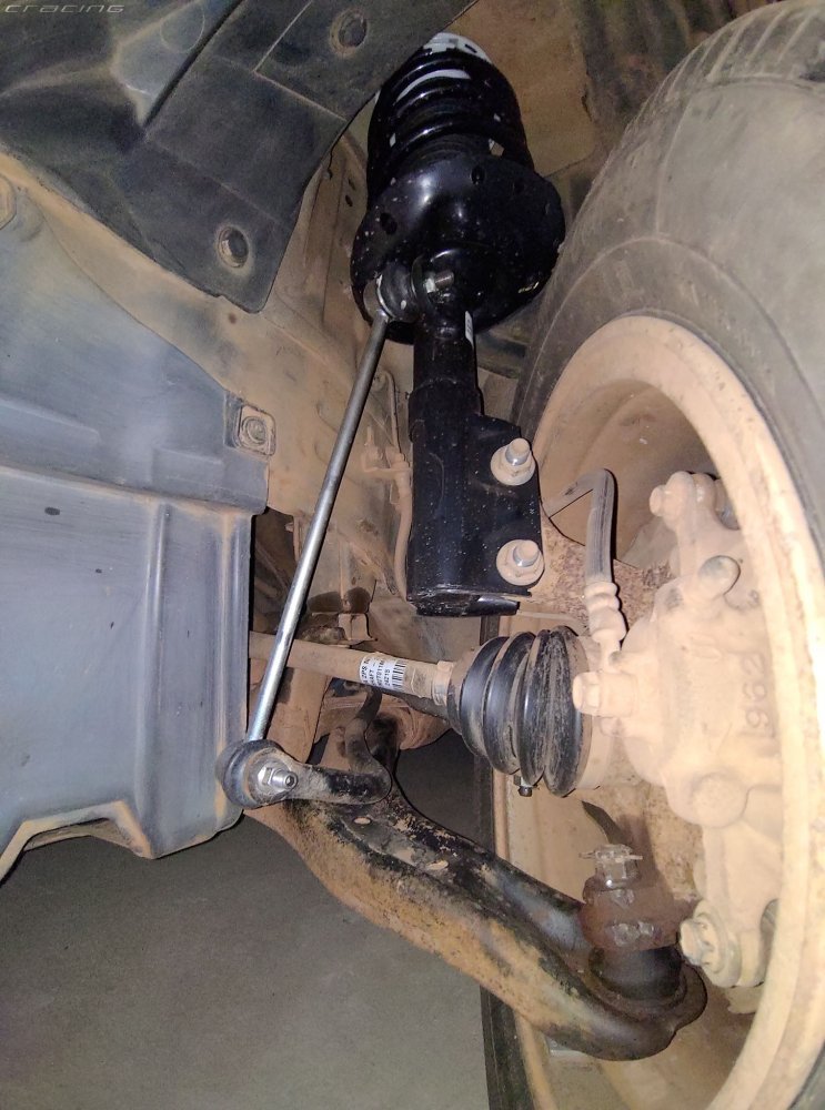

Partial Suspension Overhaul (January 2023):
Long due work is finally done, that is replacement of front worn suspension parts. The car had following issues from quite a while and of late they had become unbearable: 1. Squeaky noise from driver side strut mount when the steering is turned to full right. 2. Sagged and stiff suspensions. 3. Knocking noise from the front while going on potholes & speed bumps. 4. Rubber boot of stabilizer link and tie rods were torn and ball pin had partially play.
Last month I took my car to Honda ASC for selective servicing (Transmission oil, brake fluid and coolant replacement) and asked them to check suspension condition as well. They did a short test drive on a good but busy highway so above issues were not much noticeable. I left the car at ASC for servicing and returned back in the evening. They checked the suspension parts under lift and noticed some play in ball joints as well as in steering rack. SA said it will be fine for few thousand kilometers but still I insisted him on getting partial suspension overhaul. However, major parts will not be in stock with service center and will be ordered upon request with 50% advance payment. We selected following parts and the total estimation was 38k excluding labor. Front strut assembly and strut mounts, rear shocks, tie rods (inner and outer), stabilizer links, stabilizer bush and several nuts for these parts. Made 15k advance payment for new suspension parts and 3k for servicing as mentioned above (Invoice attached below).
Last week I got call from SA and he said all parts have arrived except rear shocks (approx 6k less from above estimation) and asked me to bring the car for installation. Dropped my car at ASC and returned next day to pickup. It was ready by afternoon itself and total payable was 35.7k which includes 4.5k for labor (Invoice attached below). They did wheel alignment and washing for free of charge. On first glance I was shocked at how much the front end was lifted (Almost 2 cm higher then rear) and all these years I was struggling with a sagged car. About 90 percent noise is gone and remaining is from rear suspensions, though it is very minor and can be heard only when windows are opened. The car rolls smoothly on uneven roads with 2nd or even 3rd gear; before I used to slow down and down shift on potholes & speed bumps.

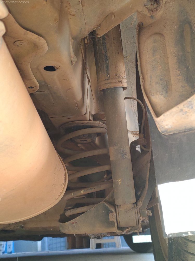

Now what I disliked is sagged rear suspensions which has somewhat spoiled the aesthetics of the car. Upon checking invoice later, I noticed that they have installed strut assembly of facelift model (51610-TM2-K54) and I thought it lifted the front end because facelift model has higher GC but later when I checked several videos on youtube (i.e here is one), even correct strut assembly (51610-TM2-K01) has lifted the front end of the car just like mine. SA said they have used latest or upgraded struts and it doesn't harm anything and will look normal when rear suspensions are also replaced. Still I have following concerns, please let me know if you guys know about it: Is it okay to use strut assembly from facelift model? does it get settled after sometime? Does it cause any problems with other parts?
My friend suggested me to get rear coil spring buffers until I replace rear suspensions. It will raise the height and normalize the look of the car but may cause stiffness so it is a little trade off. Another option was to replace only the coil springs for now but another friend said old shocks will over compress the new springs and again cause stiffness. So I felt going with buffers was a better option and I opted for AMT brand ones on Autotrends for Rs. 900/- instead of 2.2k Rogerob on Amazon. Buffers are still on way so I will make a post on them later.
Here is how my car looks after replacing front suspension parts:
Gap above front and rear wheels (2-3 cm difference):
After installing new front suspension parts:
Selective Service Invoice:
Front Suspension Replacement Invoice:

I have received AMT coil spring buffers few days ago (From Autotrends) and took some time to test drive before making this post. Installation was effortless, again thanks to the steps in my car port. Size was correct and they fitted properly with the help of soapy water but after removing from jack, there wasn't much difference in height (Maybe 1cm only) because buffer thickness is same as the gap between the spring. Product description says increase upto 0.3 cm so there is that. Whereas Rogerab buffers are little thicker and said to increase height upto 6 cm but cost of the product is double! It also depends on the condition of the spring; if it has become too weak and sagged then we can see the difference in height but the life of the buffer will degrade and break apart because it has to take stress even when the car is standstill.
However, the buffers were still helpful for my car if not for height. Now the rear end is more stable, less bouncy and slightly stiff. With rear passengers and/or heavy load inside trunk, the car doesn't sag as much as before. Noise and vibration is also reduced somewhat. So far I haven't noticed any issues but I want to see what happens if the buffers are moved to the upper end of the spring because one reviewer said it improved the performance.
I have read multiple international forums that front lift after replacing strut assembly is pretty normal but it will bed in after sometime so I hope it happens with my car too and till then I shall enjoy the SUV comfort. [drive]
Here is how my car looks after installing the buffers:
Coil spring before installing the buffer:
Fitted the buffer to the middle of the coil spring and secured with cable ties but wheel is still on jack:
Jack removed, wheels on ground and cable ties trimmed:
