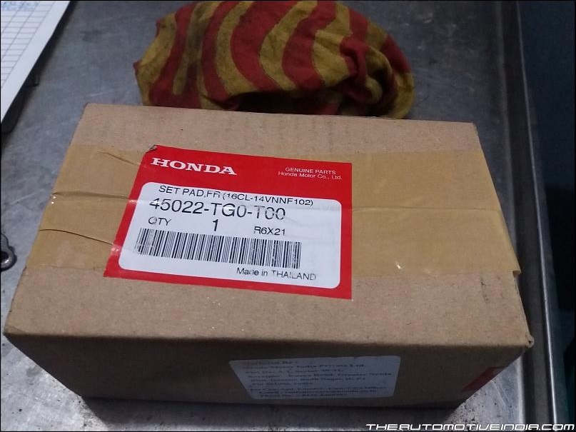

Welcome to our forum. The brake pads are indeed 5K+ in cost as I too had got the same replaced for my car last year. I am attaching below the pics of the genuine ones with price. However, for a component like brake pads, I'll suggest you to go in for the Honda genuine ones only as there isn't any point in saving 500-1000 Rs. and yet not having peace of mind.
