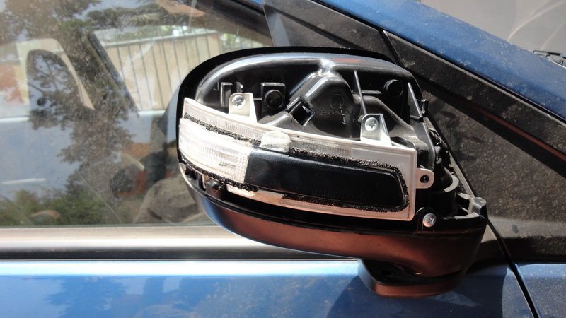

DIY on Broken ORVM Indicator
Had Once Posted about my ORVM indicator being broken by a stupid truck Driver on his carelessness and was trying for a permanent way out of it without actually getting the ORVM replaced by shelling some K's of money and finally it ended up in another DIY :cool:
As i was Doubhtful about the warranty norms , first i went to svc to make it clear that nothing will happen to my warranty and later asked themselves for removing the ORVM cap
The Broken ORVM indicator

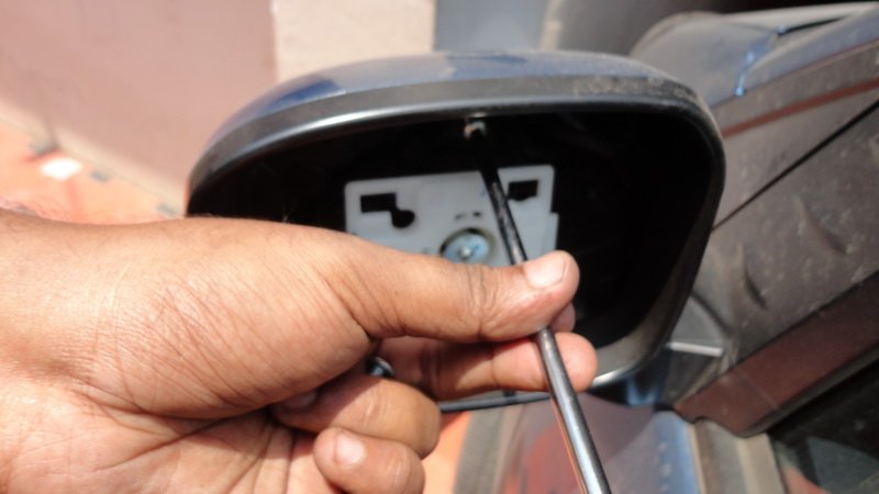

Now Fixing The Indicator back to ORVM
Remove the Mirror and unscrew all the screw's
Remove the ORVM cap
Place the Indicator and screw it
Place the Mirror

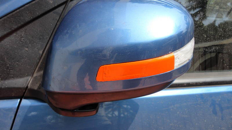

To make it look good, i've stickered the other ORVM's indicator and painted the stickered portion in the same colour[clap]
Do the Same Procedures
Apply Colin to avoid bubbles while stickering
Here i've used Orange Sticker's since anyway it's to be painted black[;)]
Mask it well before spraying the paint
Here i've used archilles black
