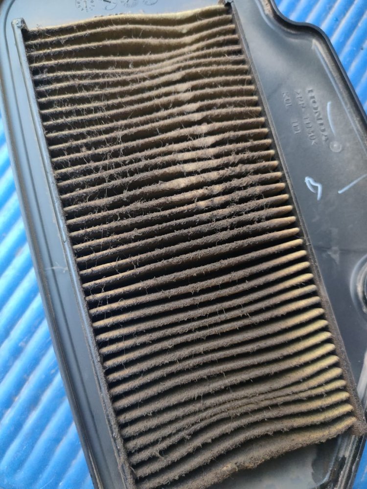

Scooter starts normally, idles normally, but as soon as you turn the throttle to move ahead, it stalls.
I am having sudden stalling issues at very low speed with my Activa. As of now I have been unable to pinpoint the cause of the problem. 2 days ago, When I entered an underpass, had to slow down to (almost) a stop because of traffic from the opposite direction, and all of a sudden the scooter stalled. I started with self , and it started without a fuss. Normal idling and sound. I accelerated to move ahead. Again it stalled. This repeated once more. Then I got down, put the scooter on centre stand and switched it off. This time I started with kick start. It started fine, and this time I surged ahead without any issue and reached home without another episode.
Since then I am racking my brain about what might be the issue??
Today I changed the spark plugs and air filter. I thought one of them might be the cause. On inspection, I found that there is lot of life still left in the spark plug. I have not thrown it away. Instead cleaned it and stored it for any future use.BS6 spark plug is very costly, as compared to BS4 spark plug. Both are NGK made. Honda OEM.
Dirty air filter cover
Dirty air filter
Old spark plug
Air intake has dust on it
Old and new spark plug
New air filter
Both old and new are NGK
New air filter installed
Air filter cover has still some dust after cleaning
Air filter cover
Inside of air filter box was clean .Means air filter was functioning all right.
Inside of air filter box was clean.
@ deville_56 you have a vast experience with 2 wheelers. You know the ins and outs of these bikes and scooters like the back of you hand.
Can you give any clue on what I might be missing here.
This sometimes happens on my 1G activa, when descending an underpass and with throttle off (Idle). if I keep even slight throttle, Stalling does not happen. I'm not sure how they carried this bug since 15 years and 6 generations!
I drove it for a couple of kms to see if the problem recurs .So far its fine. Lets see. I will drive some more and then only can reach a conclusion.
That engine of yours has a carburetor. It can get dirty or choked.Its very common issue with those engines. Here, its bs6 Fuel injection engine.Very different these 2.
Spark plug and air filter is common feature in both, hence my action on them.
Not sure, but I think it can be a clogged throttle body seeing the condition of the air filter. Seems the dust/pollution level is too high there.
Been going through similar scenario since (I doubt) the introduction of ethanol-blended fuel on all my 4-stroke carb bikes, but no issue with FIs. FZ starts on single crank and idles well and stalls as soon as I turn the throttle and refuses to start without choke and in worst case scenarios, push start. It will act normal afterwards with no issue. Tried cleaning carb multiple times, swapped plugs, air filters, and whatever I knew of. Mechanics were also clueless about this, stating just a common issue and why not use the choke. Same with the ZMA and Dio, but they won't shut down, but refuse to move, choking up and runs only on the choke till warming up. No issue when using XP95 or additives, which made me strongly suspect the ethanol blend. Still just suspicion only without any solid backing.

Suspecting Carb and check fuel hose, distributor plug. I have changed fuel hose 3 times, due to shoddy work.
It can't be throttle cable, as if that's the case, you can see visually by the worn linings. But do check that too.
