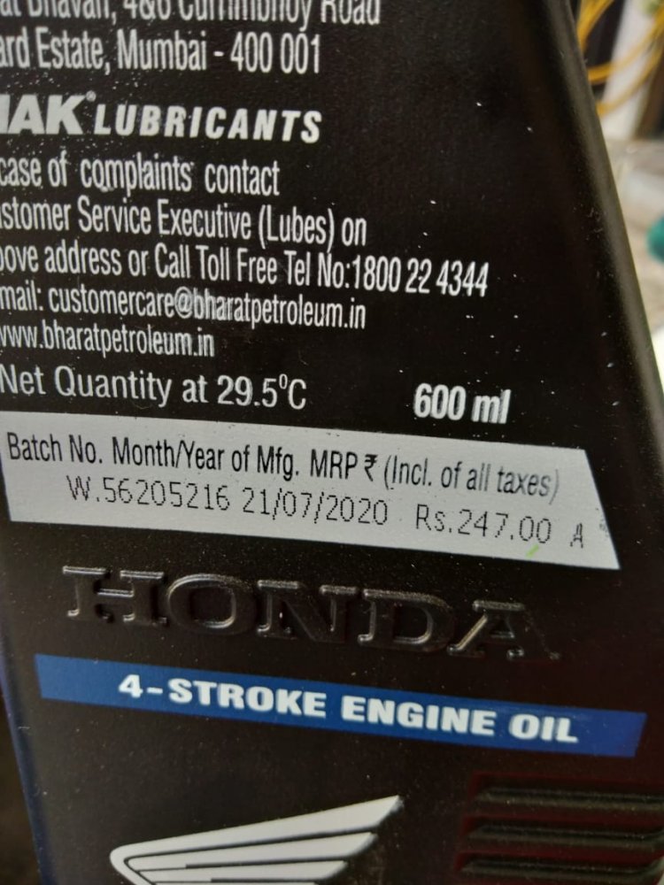

There is no confusion.Both the bills are not same but for different grades of oil, viz. 10W30 and 5W30 ,and are presented just to depict the pricing difference.
Both type of oils come in different packing too.
600 ml packing for new BS6. It takes in 600ml only.
800 ml for old scooters,which need 700 ml for service.
So you see,if you consider the actual amount of oil in the packing ,black one ends up more costly,as compared to golden one.

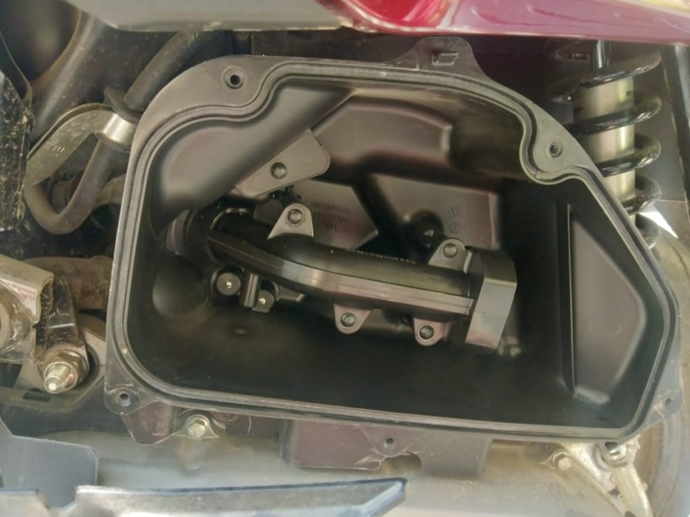

Air Filter was not changed in the service so far. Went ahead and changed it myself.
I noticed that there are lot of changes in the new BS6 scooter,as compared to the previous version.The whole frame,and bolt points ,and mounting points are changed.The look of the whole engine is changed.Its more smaller,more compact and not easily serviceable now. I am posting pics of the same.
Dirty air filter
Air filter box is different now
Look of the engine is totally changed now. I will have to understand what is what,and which thing is where!!
Previously I had thought that there is not much change is the new scooter and I will retrogradely install parts in my old scooter and improve that one too,basing my work on the new scooter template.But now I understand that its not possible.As I have already said there are lot of changes in the new BS6 scooter,as compared to the previous version.The whole frame,and bolt points ,and mounting points are changed.The look of the whole engine is changed.Its more smaller,more compact and not easily serviceable now.Even the air filter housing ,its intake design,its mounting points and the filter itself is totally changed!!
So I will leave it at that and will not think about doing any stupidity in the old scooter,and enjoy the new scooter for now.

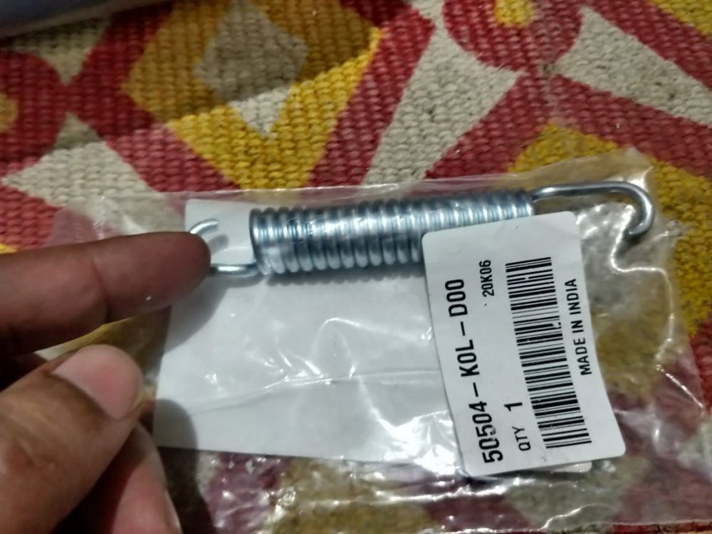

Recently the center-stand spring snapped all of a sudden while I was driving the scooter. Initially there was a bang noise below the scooter, followed by metallic sound of centre stand falling on the ground.It started rubbing the road making grating sound with sparks etc.It all happened within a span of 1-3 seconds.Since this spring breaking of its own while riding has happened to me 1st time ever,I initially thought I rode my tyres over some metallic rod or something and that has lodged in the rear wheel and is spinning with the rear wheel thus making loud sound.On getting down I could not make out what is causing the sound and I panicked little bit as the scooter was not moving backwards at all and on moving forwards clanky sound was coming. Later on only I realised that the spring has snapped making the scooter undrivable (with the failure of such a non vital part,which is not even related to engine or drivetrain or tyres even).
I went to Honda ASS.On enquiring further I came to know this problem has cropped up in many 125cc scooters from the BS6 lot,with the root cause been poor quality loose spring.It doesn't break,it just flies of due to looseness. They had already placed backorder and the part was not in stock.As a result I had to put the scooter in a corner,and drove the older scooter for few days,till the part arrived.
Pics of the OEM spring
Buying the spring was easy.Main problem was how to fit it because now Honda has made it thick and very-very tight,and it will definitely snap back to your face if at all it slips during stretching. I did not want to contact ASS just for this,because they will open a job card for even this small thing.
I used an ice pick to install it eventually by stretching it long enough to hang one end upon the spring holder protrusion on the underbody of the scooter.
