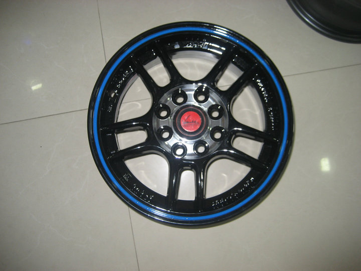

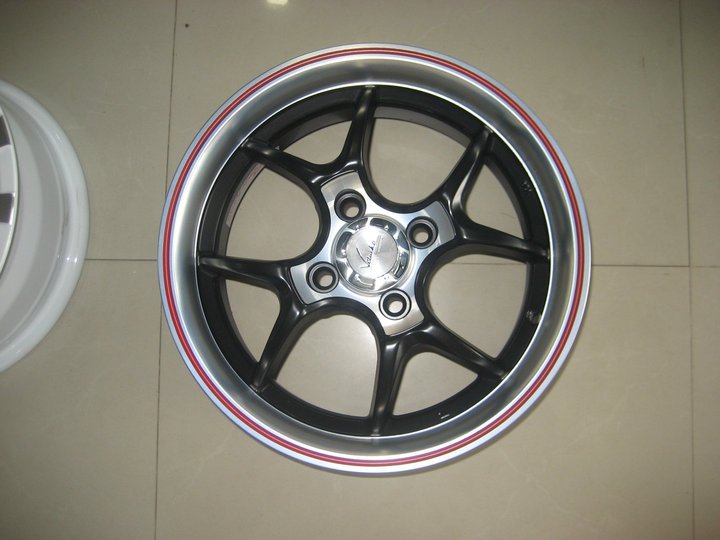

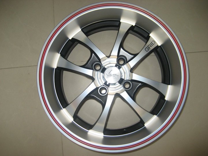

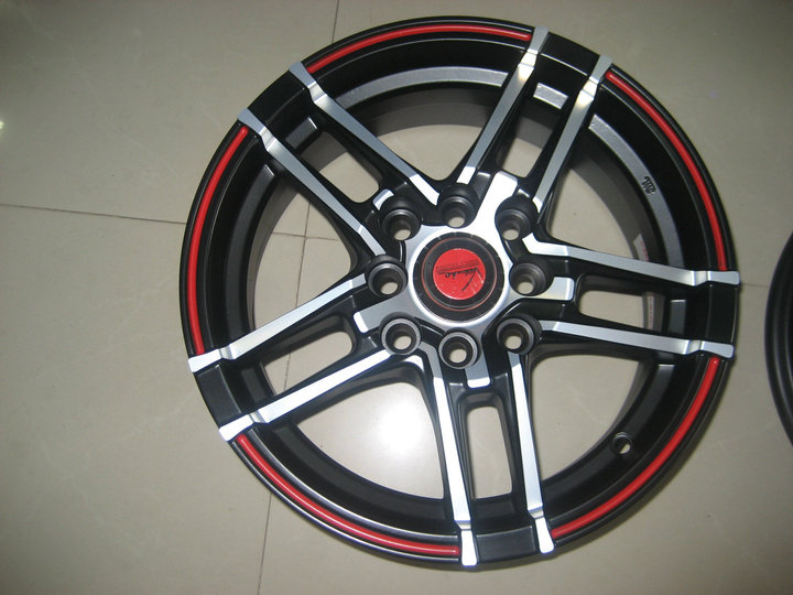

How about these patterns,they are from brands like "Veloche" and "Xtreme".
Re: Help need for alloy wheels for my ritz (white)
^^ i really liked the third one up there, Veloche one with GRID engraved, looks hot
I liked the 3rd and 4th design. IMO black wheels would suit your white ritz. But beware more the spokes more will be the effort required for cleaning them especially during rains.
Sep 16, 2009
1,571
30
Chennai/Pondicherry
The first three photos have rims with clear spokes,while the other two rims have spokes disturbed by the nut holes.
So,make a wise choice by keeping it in mind.
