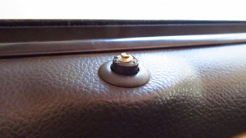

Broken door lock. Cheap though this shouldn't be happening at SVC.

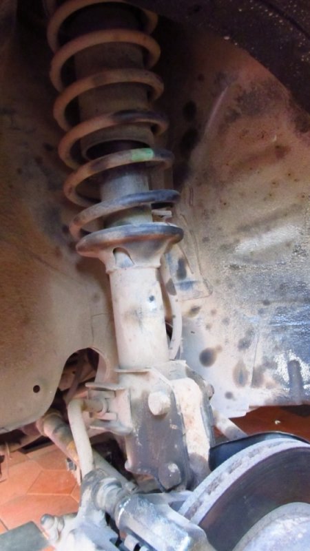

The supposedly replaced strut assembly and stabilizer bar.

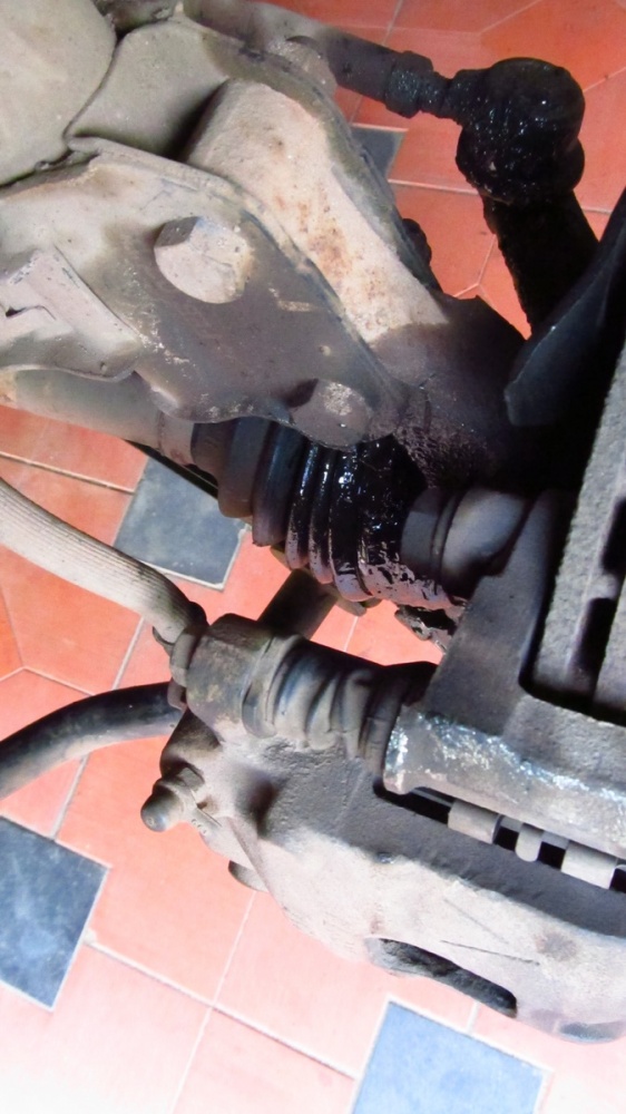

The leaky boots.
