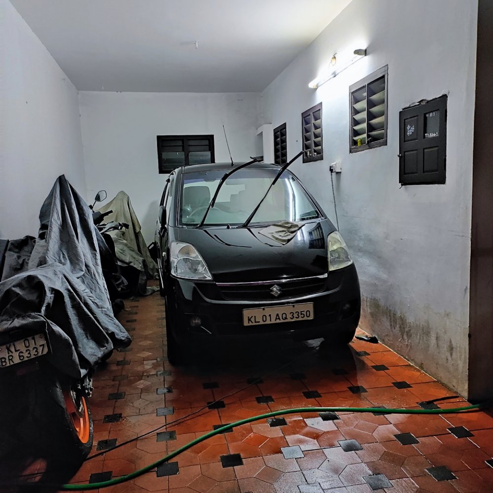

August 2021 - New Wiper Blades
Bought a pair of Minda Soft Super Blade aka frameless.

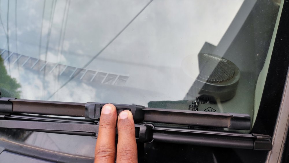

Difference between 12" and 13". Works fine without messing with each other.

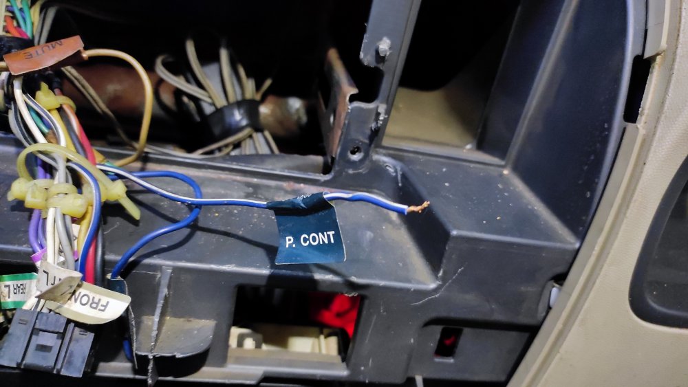

12V for the 7805 fed from the HU remote wire for amp, so powered up only when HU is on.

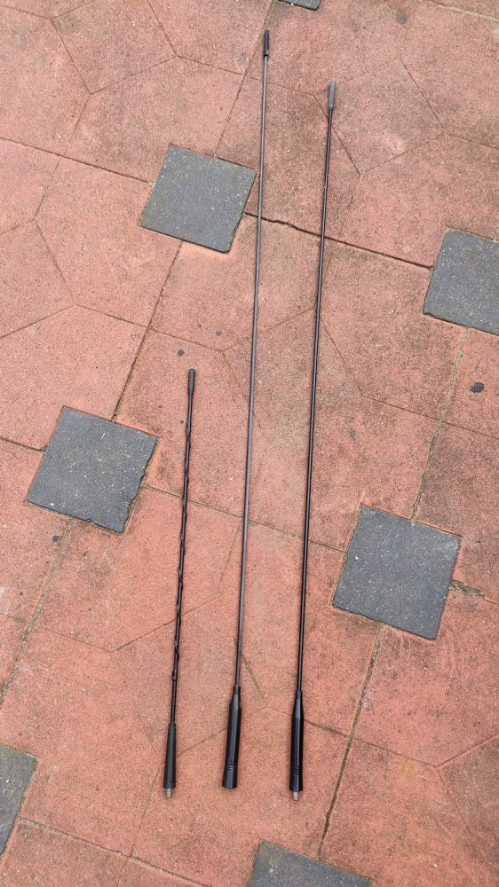

Length difference, Matiz (L) vs Estilo (R).
Estilo vs Matiz vs Beat (L to R). The whole thing came up when I was checking any one of them fit our Fiesta or Polo.

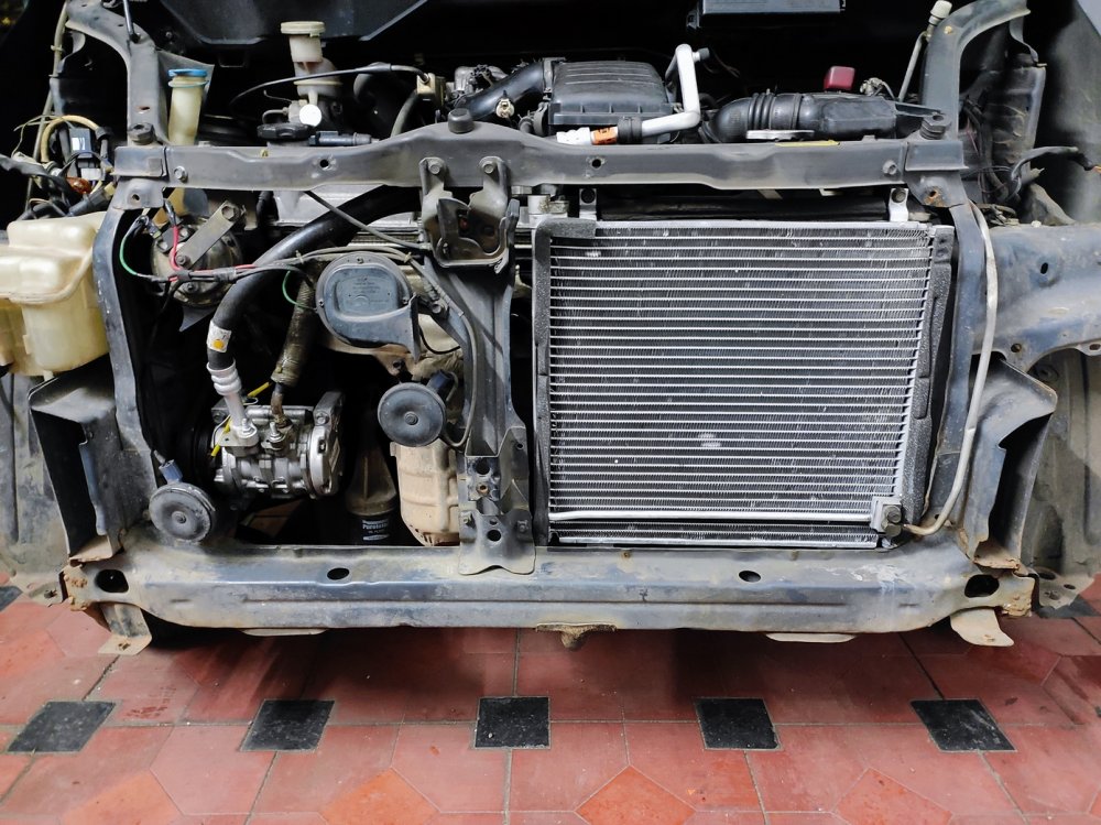

December 2021 - Major AC Overhaul
The compressor was making noise and died just before the initial lock down. Shown it to AM Motors and a freelance AC mech showed up and checked and confirmed the compressor to be gone and gave a quote of 20kish for replacing compressor and doing a leak test and gas filling. Gave it there after getting financial approval and paying advance amount for the compressor. Part was exclusive for first gen Estilo and not shared with any other Maruti models. Took 10 days for the compressor to arrive after ordering.
Car sat there in this condition for that whole period due to delay in parts arrival.
Back home. Chilling cool, but bill wasn't cool. Total came up to whopping ₹ 28,000.00. Replaced compressor, condenser, evaporator, suction hose, AC belt. Compressor alone was ₹ 17,005.00 (part number 95200M59KA0). Replaced the cylinder head cover gasket also as there was an oil leak for quite some time.

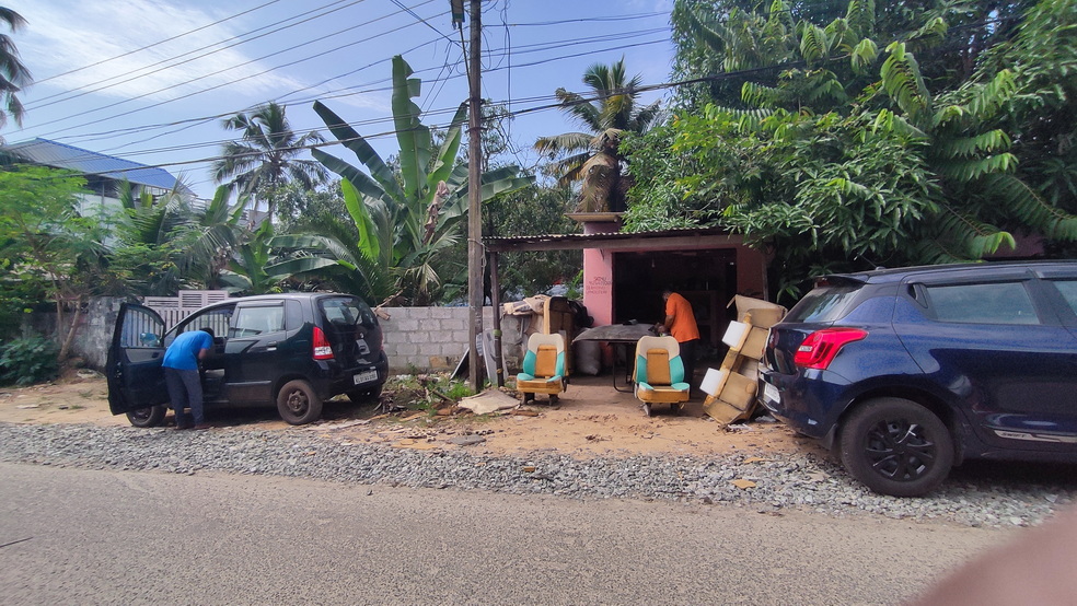

December 2021 - Seat Cover
Checked many seat cover vendors, none of them offering a satisfactory output, just plain template work with average finishing and high price. Stumbled upon this guy's advertisement in Facebook Marketplace, but no location details. Got an approximate location from one of his videos (accidental YouTube geotag [evil]), found the shop to check the quality of work in real, but wasn't open that day. Added to Google Maps (fetish) and returned another day, checked materials and quality work and got the rates. Location was a bit remote with no scope of public transport. He offered to drop back or return the car with driver seat, but came back as cousin's pillion.

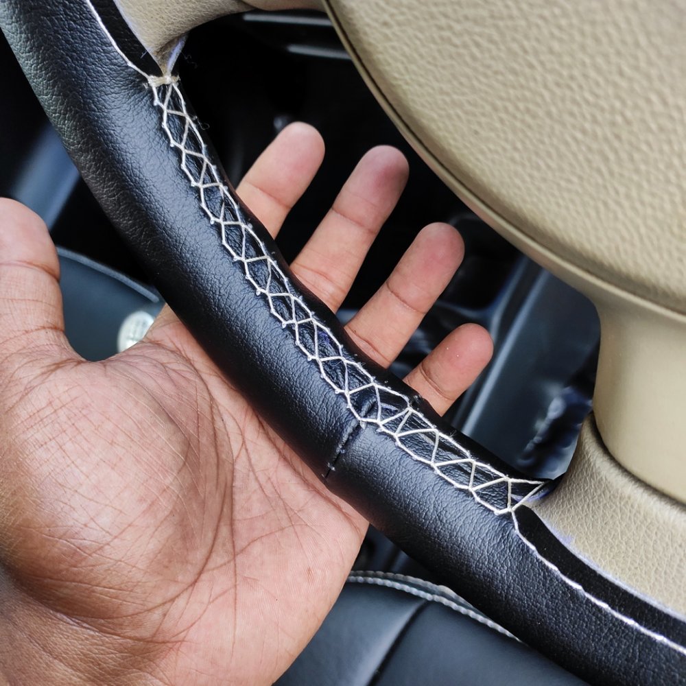

First thing first, the steering. Asked for full wrap, but due to some misunderstanding by his assistant, ended up as steering cover, but neatly stitched.
The stitch is what impressed me the most. No vendors here give such an attention.
