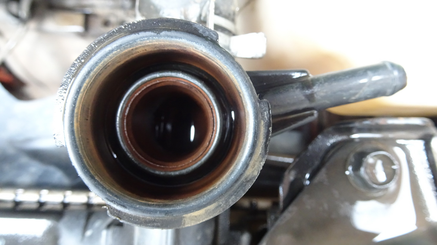

August 2016:
Coolant looked very rusty and dropped in level. Flushed and refilled.
Mumma's vineger [lol]. Poor man's radiator flush.

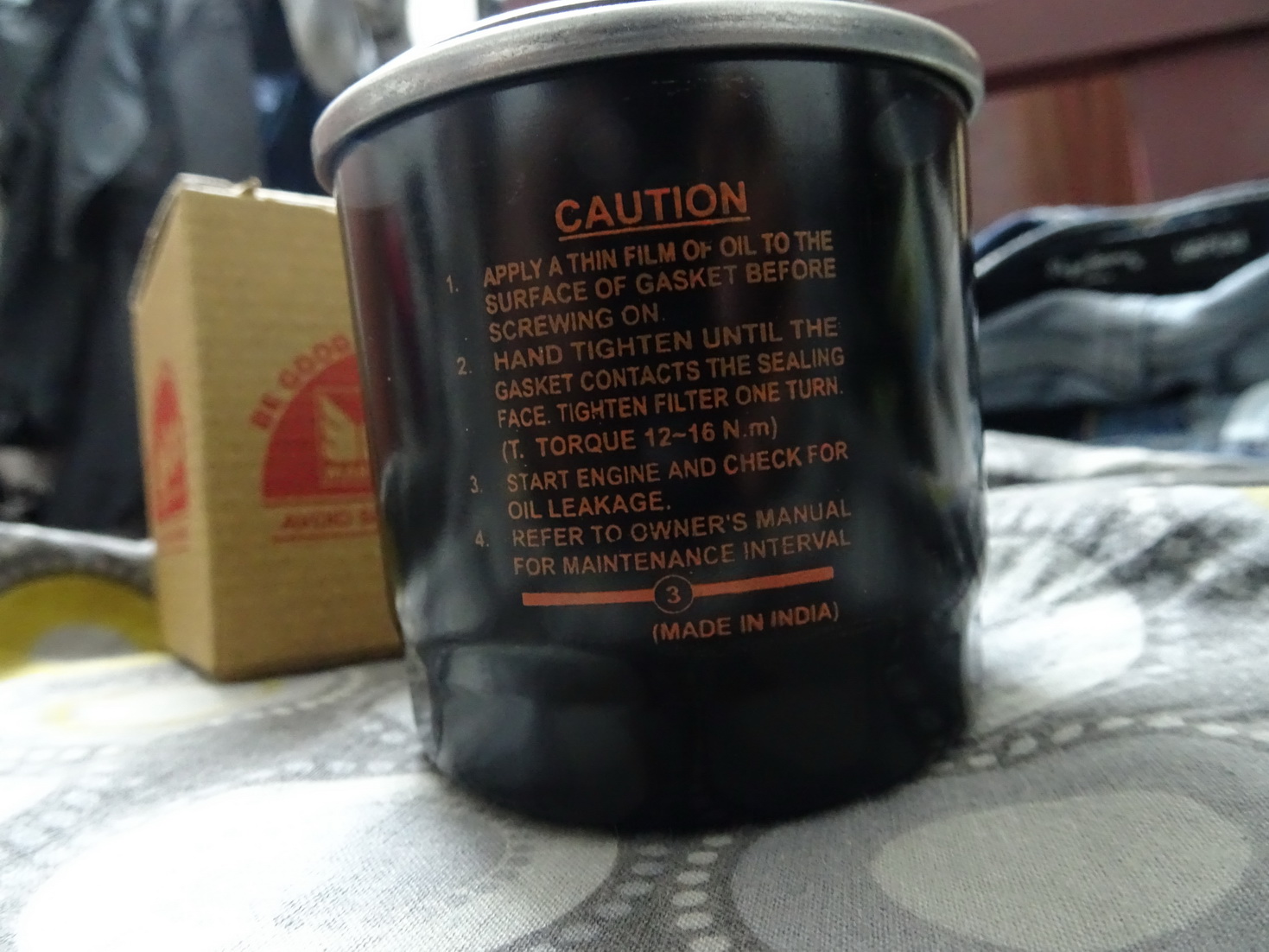

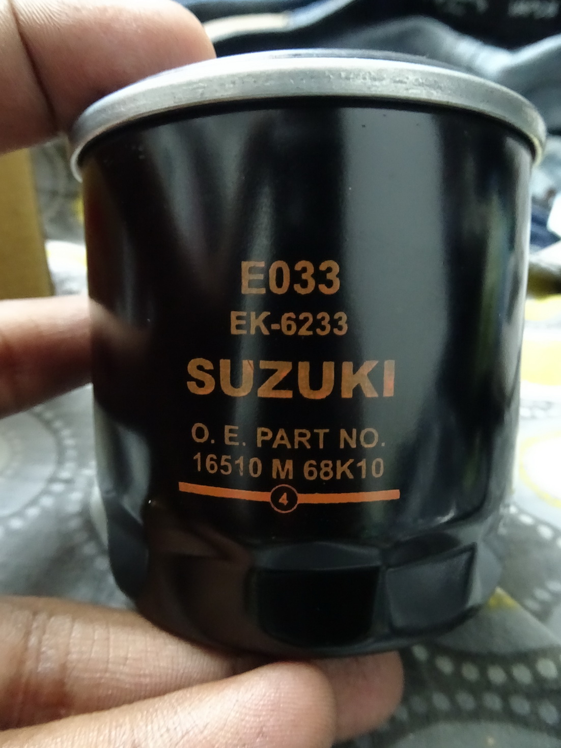

Oil change time. Bought parts from MGP and oil from Kaikkara, Pongummoodu.
Oil Filter - 16510M68K10 - ₹ 90.00

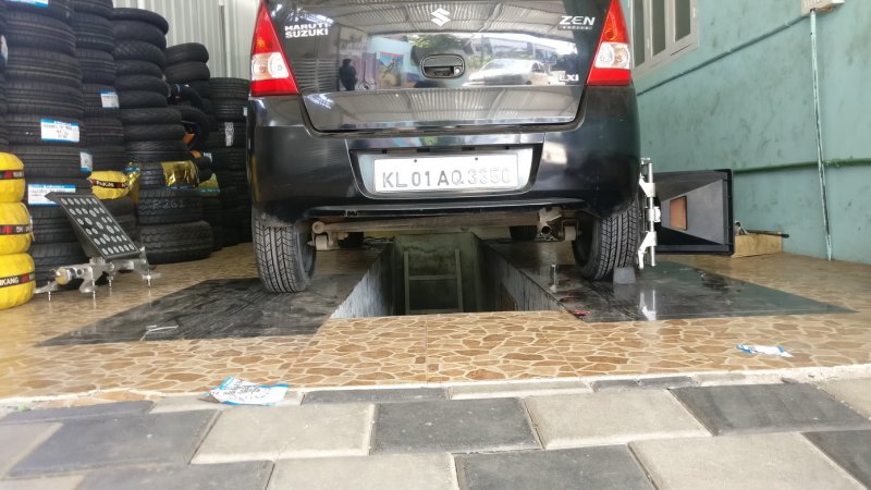

New tyres. Nankang N729 165/65R13 Tubeless - ₹ 10,000.00 for set of 4. From The Tire Club. Supposed to get 4 new tubeless valves free, but 2 rims were rusted and they were not confident in removing old ones, so only gave 2 and used the old ones. Alignment and balancing free.

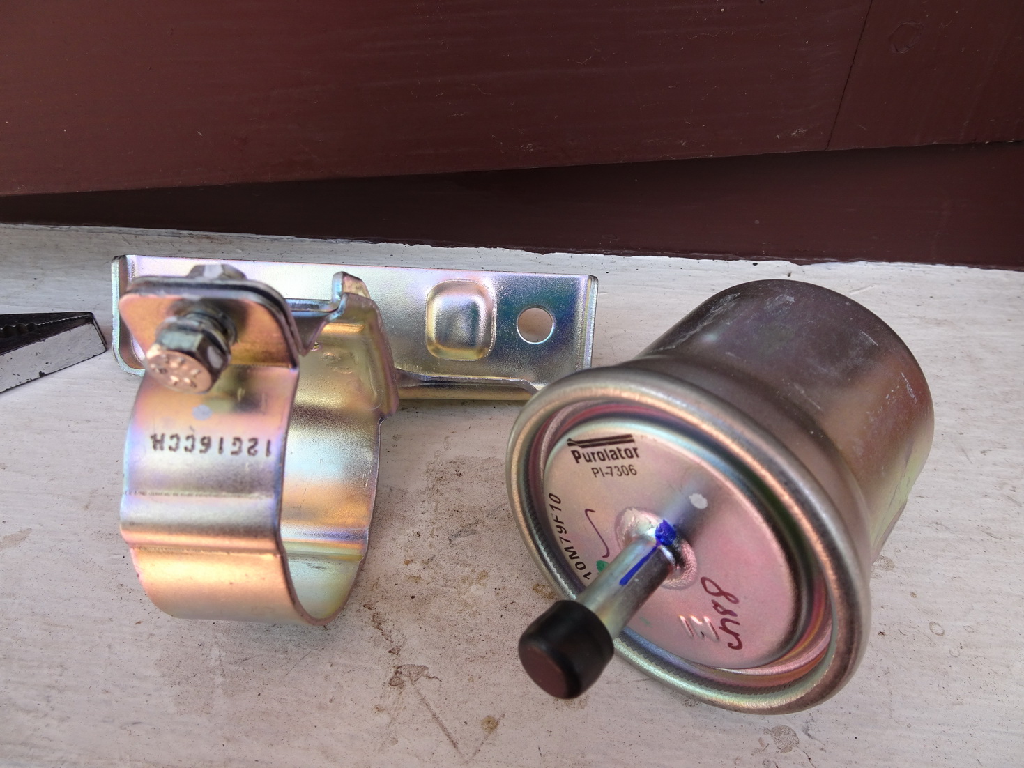

Bought fuel filter assembly. Yet to fit. Paid ₹ 320.00. Brought from MGP. Part # 15410M79F10

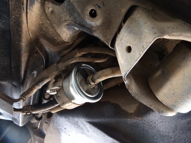

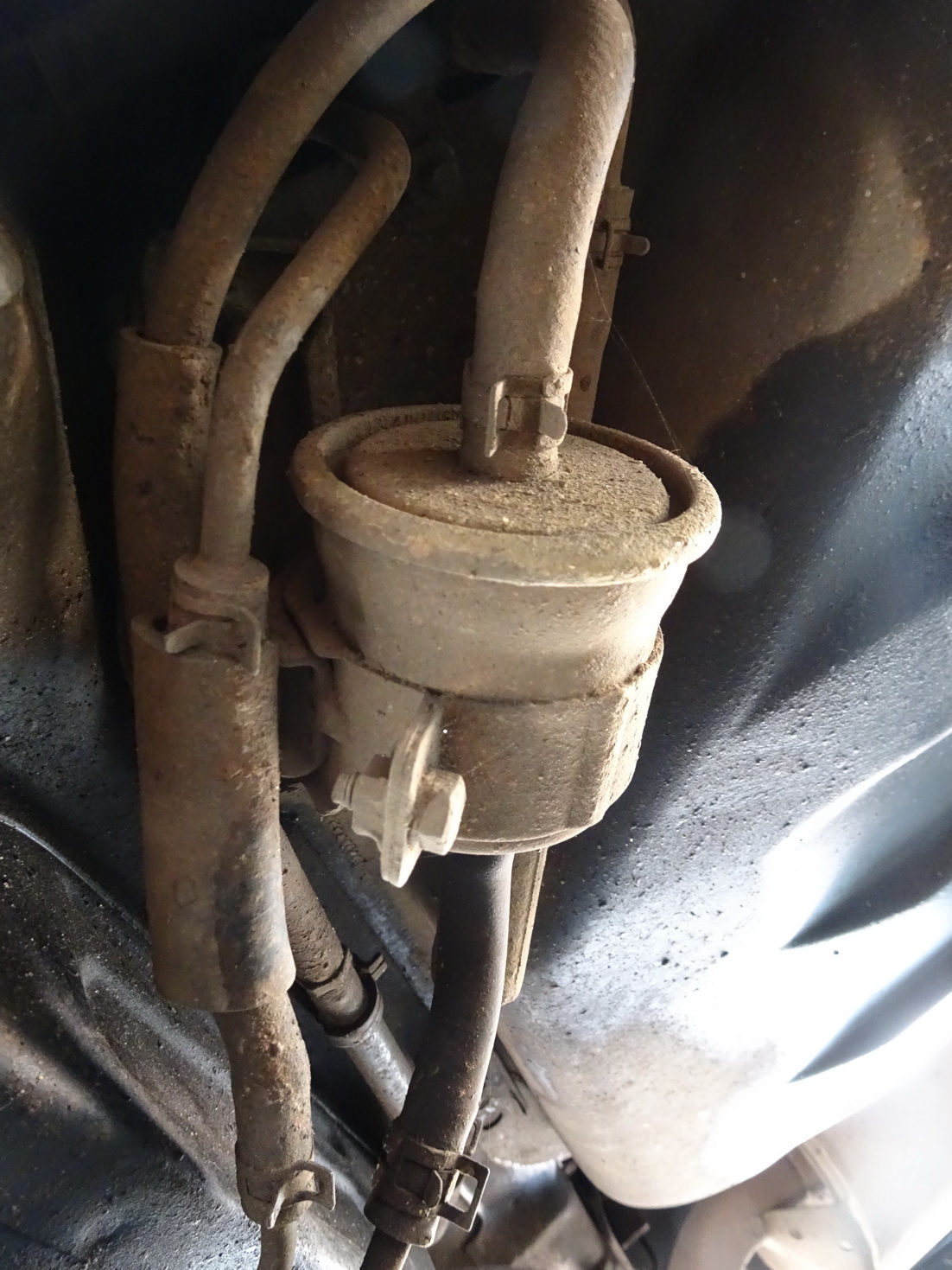

Finally changed fuel filter.
Mount bolt hindered by brake hoses.
Removed from clamp.
Mounted on old clamp.

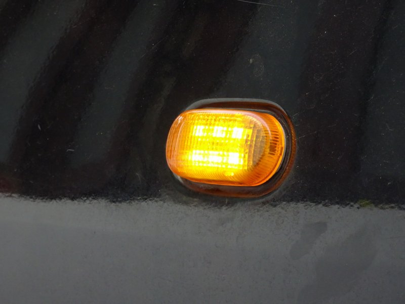

New side marker. Bigger 5730 LEDs this times, same ones coming in household LED bulbs.
Park
Turn

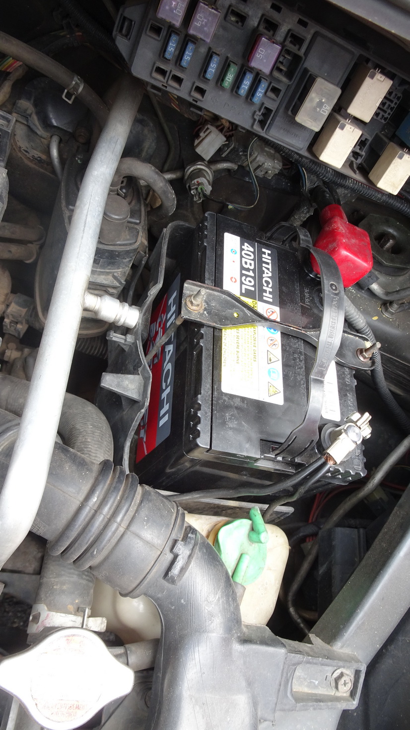

Classic signs of a dying battery. Amaron died at 4.4 years.
For a change wanted to try something different. Saw Hitachi 40B19L at battery shop. ₹ 3,400.00 (MRP ₹ 3,900.00 minus ₹ 500.00 for old battery)
Made in Thailand and OEM for Mitsubishi.
Maintenance Free.
Battery condition.
Always put in a paper or cover between battery clamp. This prevents oxidation caused by conduction leak in case electrolytes coming in contact with clamp (and also prevents current leak through clamp). Our clamp was severely oxidized because of this.

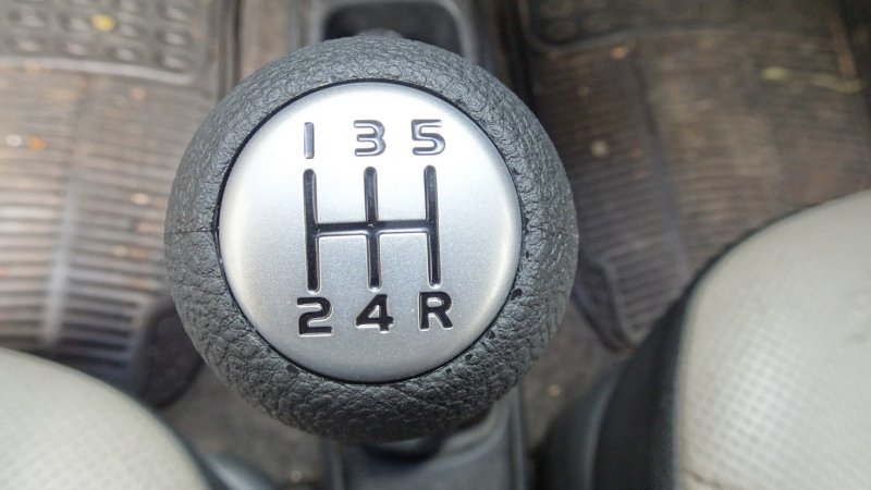

New gear knob. Third one in 10 years. This time bought Swift's. This one was significantly heavier than Estilo and Alto K10 knobs. Hope this will last. Costs ₹ 378.00 compared to ₹ 97.00 for Estilo one.
This time also did not get adapter. Salvaged old knob and used the old adaptor.
Fixed DIY

Did you get the knob from MGP store in killipalam?
I'm too looking for a replacement for my Zen and doesn't want to go with the stock knob.
Got from Swaraj. Don't forget the adaptor.
