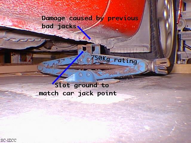

Very good explanation 350Z.very helpful.But one thing went wrong here was that u placed the jack upside down.The larger base should be on the road n the smaller one to lift the car n u have placed the two in the opposite directions.Also its better to place the jack such that the body first gets lifted and then the axle.that is y the jack has a cut to be filled by the car's body.lifting the axle directly from jack is a very good shortcut but may damage the car since it is not recommended even after being an easier way of doing the job.

You're correct, Alok. I happen to notice the upside down jack after uploading the pictures. Cause of hurry. Eh? This will be corrected soon. About the second part - Maruti's representative too demonstrated the same method (As I did) for rear wheels.

Dude, apologies if this sounds rude, but that was probably the most unsafe jack position. The flat side is meant to be on the ground, if the maruti dealer demonstrated it this way, I suggest he be fired straight away. He knows nothing about cars. scissor-jacks.png
Other than that, good tips.

Can't rely on the A.S.S people almost at all stations anymore. They are a bunch of chimps who are jacks of all and masters of none. I am really going crazy when I have to visit the A.S.S for things you can't get done outside. Shocking to learn the method they demonstrated to jack a car. I did not notice earlier that the jack was upside down.
