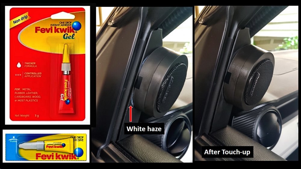

Very useful article as I am thinking of a simple upgrading of my car stereo system.
You said, you have pasted the tweeters on the IGNIS ‘A’ pillar tweeter mirror garnish (that’s what the part number says) using ‘Fevi kwik ‘Gel.
Is it the yellow one? Again, why can’t we use original 3M double sided tape? Please guide me.
Thank you Sir.
Dr MUDHAN
Sep 3, 2013
895
2,252
No, the yellow one is very instant; once fixed it can’t be adjusted immediately. The red one GEL Type is little thicker, takes few more seconds to bond and allows us to adjust the position if needed.
These are Cyanoacrylate adhesive, to be carefully used. Do not put excessive drops, if it gets stuck to the fingers - Dip the affected fingers in cold or warm water & Do not force peel off; will go off later slowly.
If applied to Black colored plastics it may show some white haze due to their reaction, it happened to my speakers and I masked it with black matte finish paint touch up.
Actually I tried with original 3M DS Tape (allowed 12 hours to bond) and also by Glue Gun. It worked, but one side tweeter got detached while the car kept in the hot sun, also if someone force closing the door, they may get detached. Don’t forget to secure the wire inside by using glue gum as it greatly helps the tweeter in hold in case the adhesive fails.
