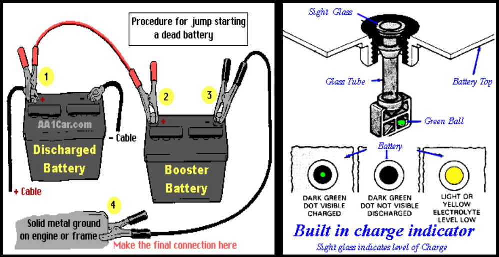

ABOUT CAR BATTERIES HAVING A BUILT-IN HYDROMETER - COLOR INDICATOR
Some car battery also has a color indicator which displays battery status & it still requires distilled water to be added as the battery is not fully of zero maintenance.
These sealed-top batteries have a built-in hydrometer to indicate charge. The charge indicator only reads one cell, but usually shows the average charge for all battery cells. A green dot means the battery is 75% or more charged and is okay for use or further testing. No dot (a dark indicator) means the battery is low and should be recharged before it is returned to service or tested further. A clear or yellow indicator means the level of electrolyte inside has dropped too low, and the battery should be replaced.
Actually, Battery state of charge is often indicated by a float device built into the battery. It contains a small green or other color ball that floats when the electrolyte specific gravity is within a certain range. Below this range, the ball sinks. When the ball is floating, it shows as a bright green dot indicating the battery is 80 percent charged. When the ball sinks, the unit shows up dark, indicating the battery is discharged. If a light yellow color is visible, it indicates the electrolyte level is too low. The indicators fairly give us an idea what to with the battery.
