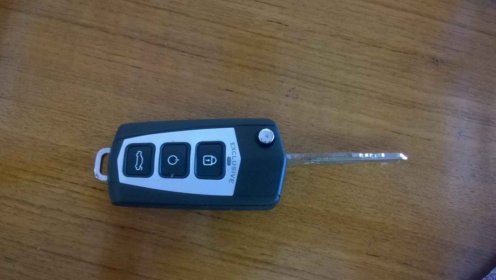

What's the durability of the form-factor of these flip keys? Any feedback, do they look like original or cheap plastic?
Also is there any same vendor near NOIDA area?
The durability of the flip is alomst like original flip key provided by the manufacturer.
I have been using the flipkey from a year, no problems faced so far[:D]
I have turned my normal hyundai Eon Key with Autocop Remote into a 2-Button Hyundai Flip Key.
I turned my normal keys into flip key from Harison Keys, Panchkula, Haryana.
