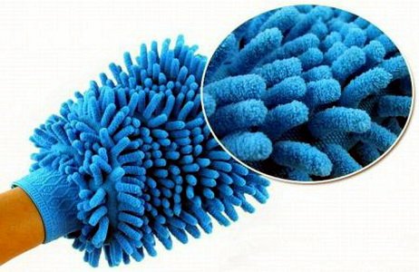

4. Put your wash mitt in the wash bucket, Dug the wash mitt and grab some solution along with it, don’t squeeze and wipe your car’s body with a light hand.
5. Wipe an area of a panel gently. Flip the mitt and wipe on new area.
6. Rinse the mitt in your rinse bucket.
